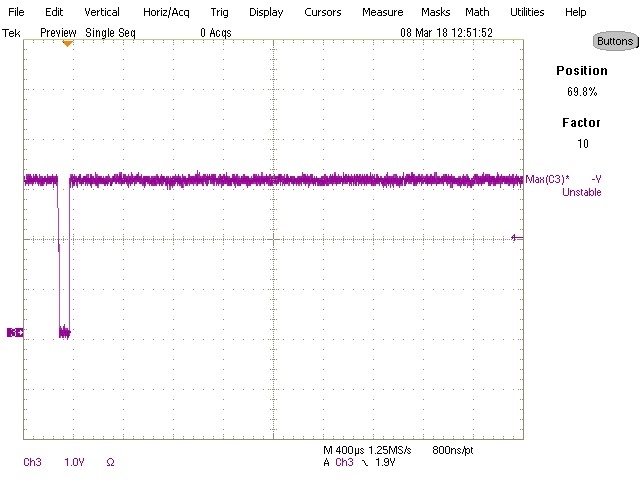

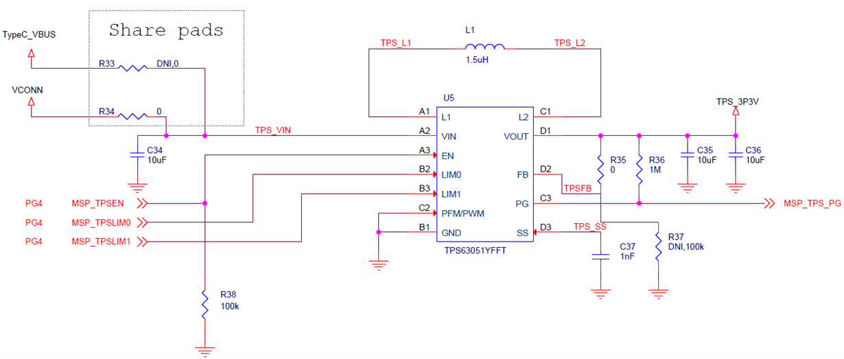

I am using the and the VOUT and PG will drop for a short period of time at changing state of another device the TPS63051 is supplying. The current drawn from this device does not nearly come close to the current limit. the device is not in undervoltage lockout or in thermal shutdown. I have large ceramic caps(2*10uF) on the power rails and around the device(4* 1uF) that is being supplied by the device. Is there any other reasons that the TPS63051 would drop VOUT low for a quick instant when the other device changes states?
