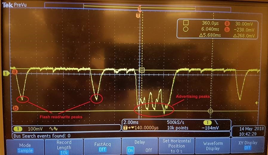

Hi
The system's input voltage is 6-4 V, and the TPS62745 output is fixed to 3.3V. The system includes nRF52832 (SOC) and SPI Flash.
The peak load is around ~24 mA (nRF52832 advertising + read/write Flash).
when the TPS62745 input is 4V, the Load Transient Response increase to ~ 270mV and more- see attached picture .
when the TPS62745 input is above 4V, the output ripples are around 20mV which it's OK.
1.Is the TPS62745 can't work without ripples while input 4V , output 3.3V with ~24 mA load ? do i need to replace the TPS62745 ?
2. Is it possible to reduce the Transient Response high ripples? If so, how?
Please advice
Thank you
  • Hi Nir,
    Is it possible to add the Vin and load current to the scope, as well as Vout? There may be significant input source impedance which accounts for part of the drop.
    Is your maximum load current 24 mA? Does this include the load during the peaks shown in your waveform?

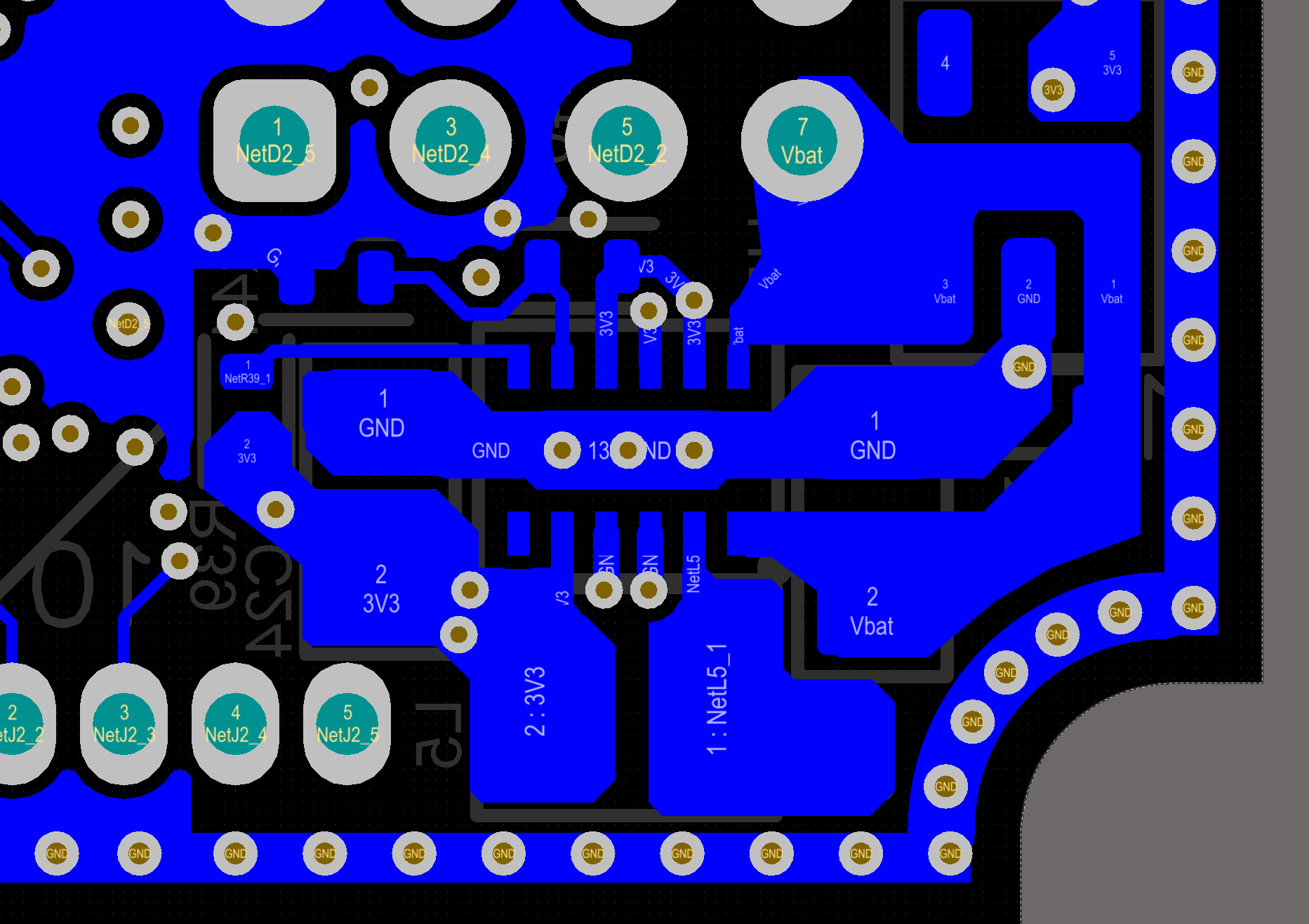

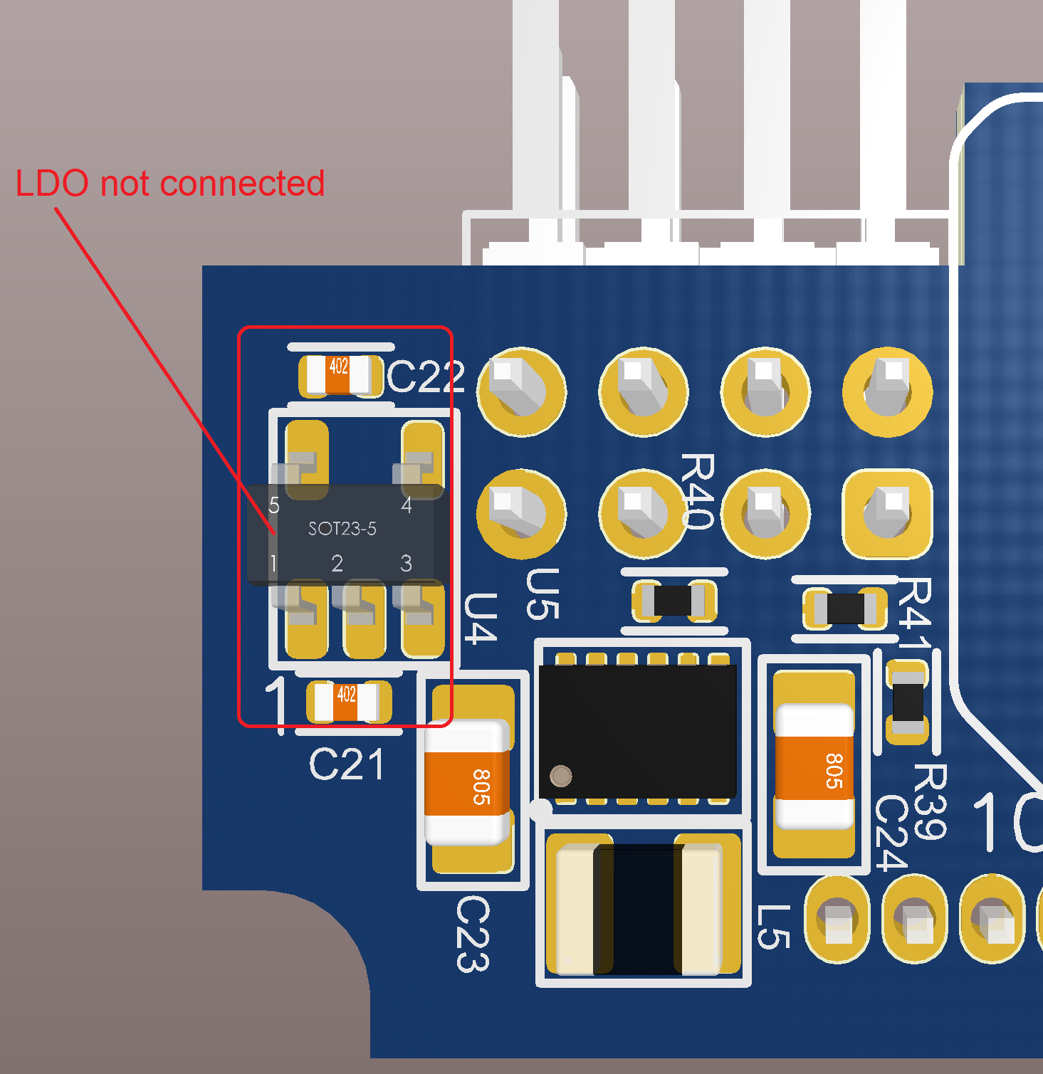

  • Hi Chris ans Nick
    Thank you for the reply, appreciate your help with that.
    Nick - It is very clear that there is a big difference between the results of your measurements compared to mine.
    please review design and schematic below:
    *please ignore the (nc) at the schematic , all components are connected
  • Nir,
    I do not see anything wrong with your layout or schematic, assuming that R40 and R41 are not both populated. Your GND pins should also be shorted to the thermal pad, but I don't think that would be causing such a big transient.
    Would it be possible to see a waveform of Vin and Vout at the same time? If there is a drop with Vin that could be adding to this problem.
    What would also be nice is if you could find some spot to solder in a resistor or wire that could be used to measure the current since I believe that would get us the most accurate measurement of current load. Unfortunately I don't see a good spot to do this in the section you have shown here.
    You could also try connecting an EVM to this board and see if that solves the problem.
    Thank you,
    Nick

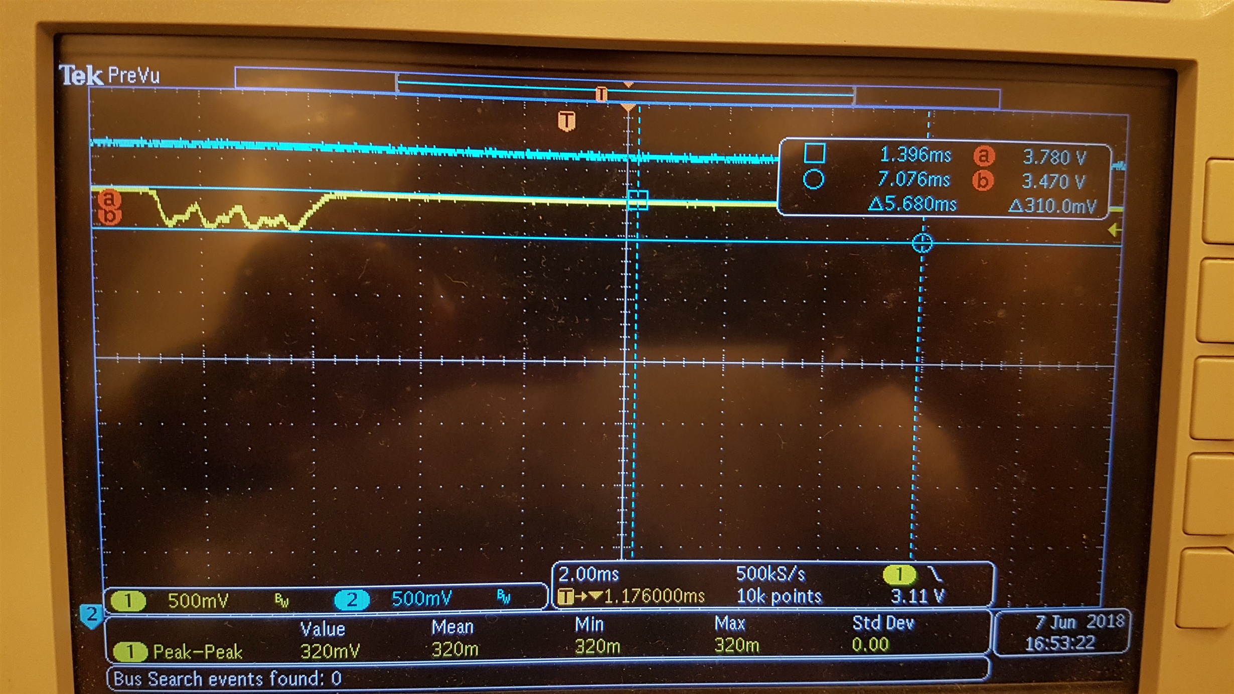

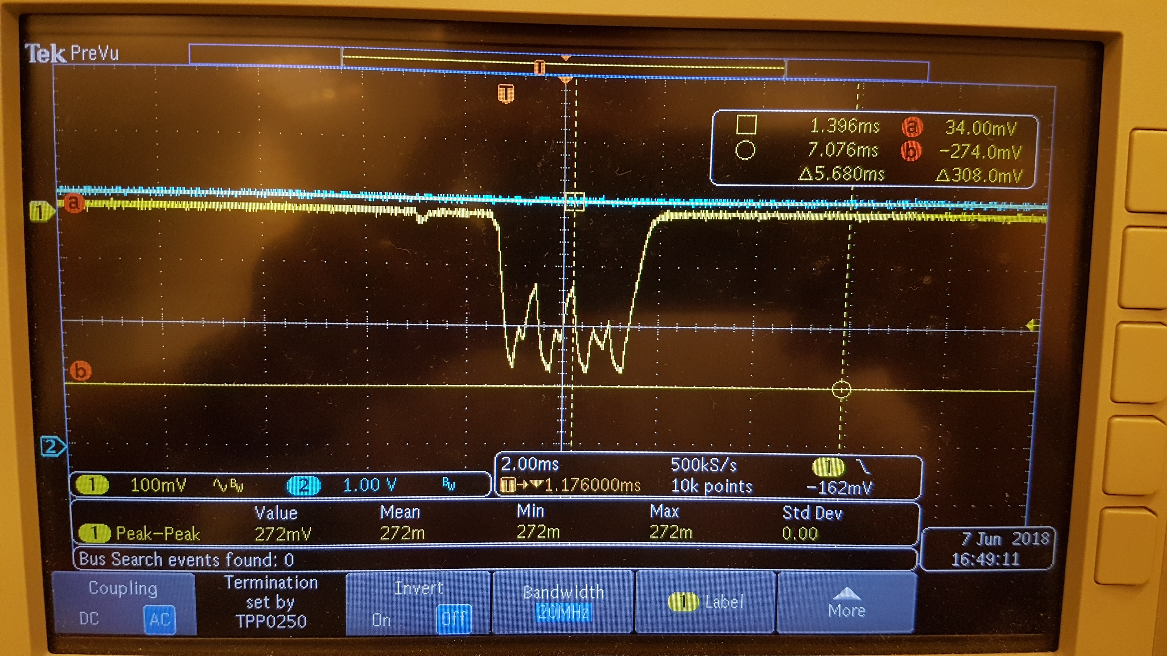

  • Hi Nick
    Apologies for the late response
    unfortunately i don't have EVM
    Please see the Vin (4V) & Vout measurements  below:
    DC measurements  :
    AC measurements  :
  • Nir,
    You input voltage looks fine.
    Are you measuring the output voltage using a low inductance probe across the C24? Your probe should use a small wire wrapped around the barrel of the probe to connect the GND instead of the typical wire clip that the probes come with.
    Is there anything else besides the nRF52832 connected to the 3.3V rail? Or anything else between the load and this converter such as a ferrite bead?
    Thank you,
    Nick
