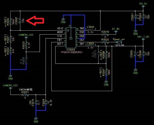

TPS62410Phase margin
TPS62410:The 33P capacitance of this IC, as shown in the figure
Considering the material supply problem, we adjusted the 33P capacitance to 47p capacitance, and measured the relative phase margin. Compared with the test result of 33P, the difference was not significant.
Is it reasonable to adjust to 47p, and the choice of the capacitance?
