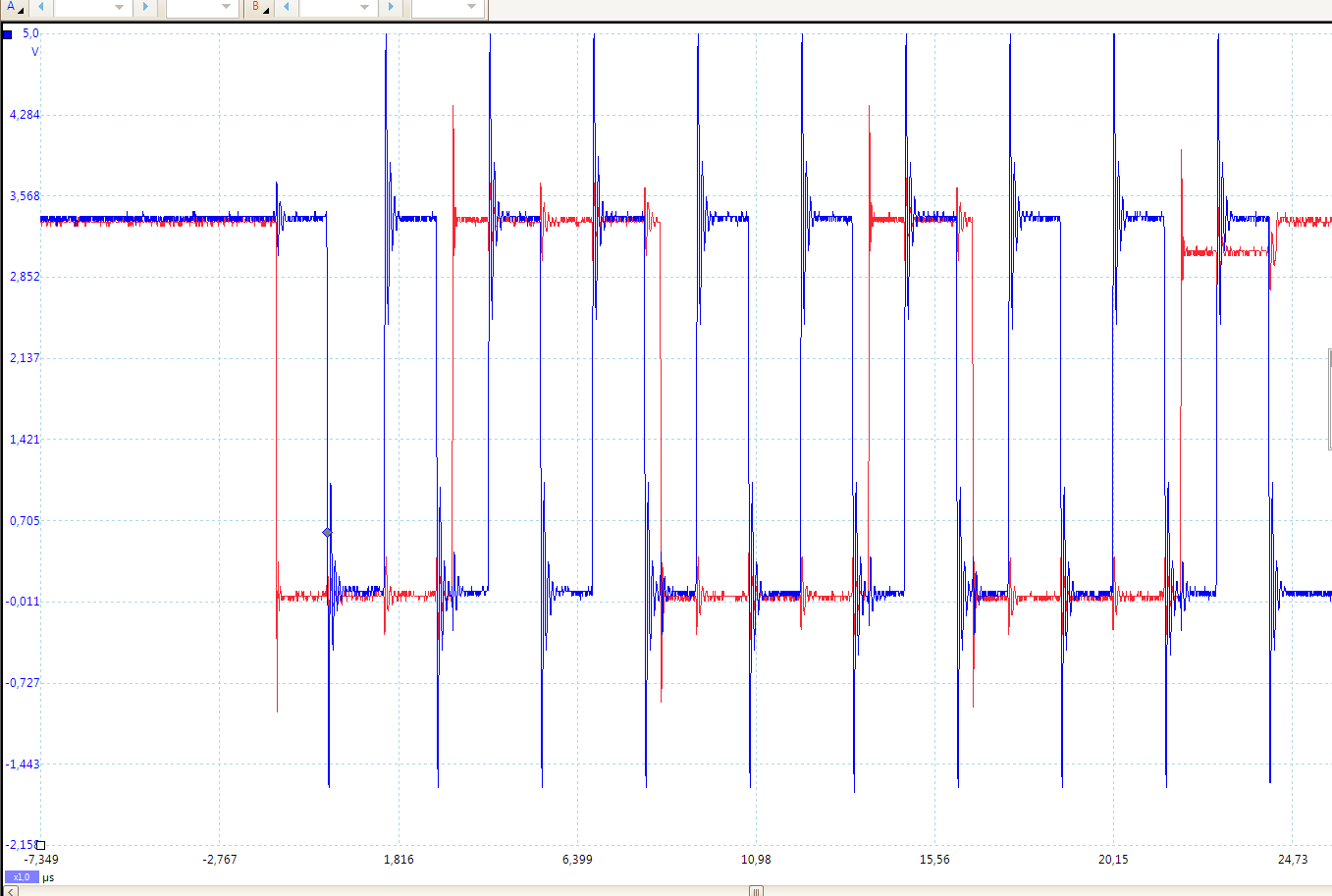

The address is sent MSB considering the pinning A0 A1 both to ground, when wanting to write: 0x64.
There is no valid acknowledge. The acknowledge at the ninth clock is going only less 20% down instead at least 80% to be recognized.
Is the pin defect? The I2C SDA pin where this happens goes down to -1.7 V for about 50 ns when switching from high to low. Could this have damaged the SDA pin or is this 20% pull down not an intended acknowledge?

  • Hi. Norbert,
    Voltage below -0.3V on logic pins could demage the pin even for a short time according to datasheet.
    I suppose the acknowledge is good before, is this correct?
    Please send me the picture if you can.
    Thanks.
    Kenneth

    Connections:
    No, sorry the SDA acknowledge did never come better than shown below. But the peaks were from the start and the peak situation is shown in below picture: Red is SDA, Blue is SCL.

  • Hi, Norbert,
    The ack signal is not able to be recognized and it seems internal circuit is wrong.
    Please try using another good unit to compare and confirm whether the internal circuit is demaged.

  • Hi Kenneth,
    thank you for your answer.
    Unfortunately we have only 2 boards and on both same signal situation. The peaks were also from the start as visible. Isn’t it, and sorry that I still have something to ask, that these peaks need to get eliminated anyway? The peaks to 5 volts I have seen also in other and UART applications. But those under 0 volt not so much. For being sure to stay in specified area, we should change this situation, isn’t it?
    Best regards and thanks  Norbert

  • Hi, Norbert,
    The peaks under 0 volt is too large and exceed -0.3V. This may causes porblem for internal circuits.
    Would you help to eliminate it and try again?

  • Dear Mr. Kenneth,
    the problem was, that our controller kept the acknowledge high because open drain on SDA was not enabled. I am sorry, I thought that would be done and I did miss that.
    The driver works properly even with these Peaks!!
    One driver on one board is still crashed. Should we put a protection to reduce the Peaks for long term usage or is that irrelevant? Please answer even when I pose the issue as resolved!
