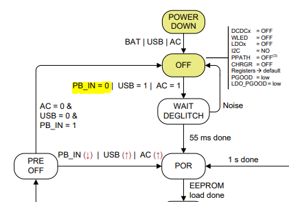

  • Paul,
    It is clear to me that the hardware of the PB_IN pin can detect levels and only the digital logic of the state machine requires edges for certain transitions.
    When powering on for the first time from the POWER DOWN state, any input power will enter the OFF state. Exiting the OFF state is allowed is PB_IN == 0 during the initial power-on.
    However, edges will be required to make a transition from PRE_OFF or SLEEP states back to ACTIVE. This is important because if the OFF bit = 1 & PWR_EN = 0 then the PMIC enters PRE_OFF. If AC || BAT are still high, the PMIC cannot transition to OFF unless power is completely removed on both AC && USB. To transition to ACTIVE from PRE_OFF, an edge on PB_IN or the other line power supply (AC or USB) is needed.
    I did test to confirm that when PB_IN is held low during start-up it generates an interrupt and the Status bit indicates the Push-Button is pressed:
    Please read the Global State Diagram (Figure 24 on page 39) in the TPS65217 carefully and make sure that this functionality will work correctly in your system.

  • Paul,
    If AC and USB are both connected to GND, as the TPS65217x Schematic Checklist suggests to do when AC and USB are un-used, then the PMIC will be able to transition from the PRE_OFF state to the OFF state if PB_IN is de-asserted (high logic level). But as you have already pointed out, if PB_IN needs to be high to get to the OFF state, then you will need an transitional edge to get PB_IN to be low, so the point is indeed moot. PB_IN must be high when the device is ACTIVE, and must go low to get back to the ACTIVE state from PRE_OFF or OFF before PB_IN returns to the high level again.
    The connections of AC and USB to GND are also shown in Figure 62, titled Case (3), on page 77 of the TPS65217 datasheet. In addition, please make sure you connect TS pin to GND through a standard 10k resistor (not an NTC), so the PMIC will always detect that the "battery" temperature is within the allowable boundary conditions.
