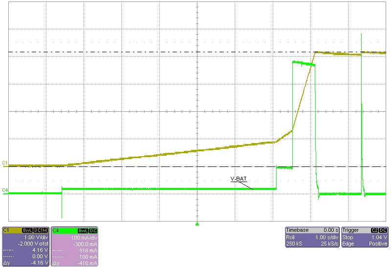

  • So I left one of the failed units plugged in overnight. The external load is disconnected, so the actual load is <10mA. Measured voltage across the cell is 1.27V. DC current is 55mA. This suggests that the chip is allowing a very very very slow charge - this corresponds to neither your description of the short-detection circuit nor the datasheet's description of the expected pre-charge behavior. Should I try replacing the chip itself?
  •  Try testing the charger with a large capacitor, 1000uF to 100,000uF in place of the battery.  It should go thru the different charge phase stopping at 4.2V.  I set up an EVM with 9.1k pre-term and 576 ISET and charged a 100,000uF capacitor from 0V to 4.2V.  See attached, noted V-BAT should be Current To Capacitor.
