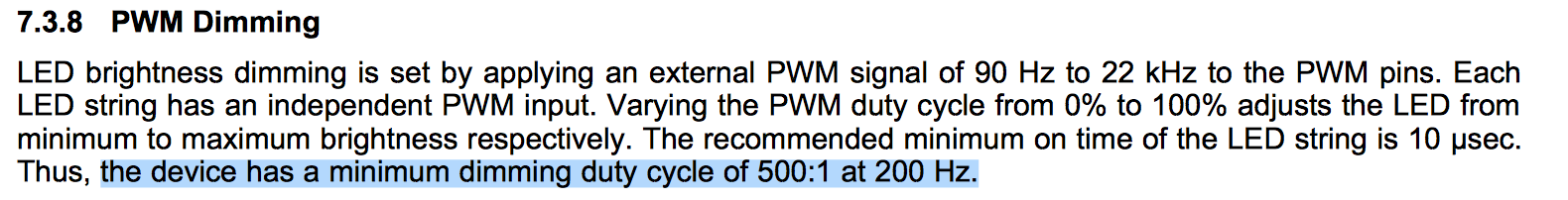

Another problem is that we found a paragraph of text at 7.3.8 PWM dimming as below.
If the minimum on time is 10uS, I think maximum dimming (5000:1) is happened at PWM frequency 20Hz, right?
Anyway, could you help to clarify the maximum dimming rate and happened at which PWM frequency.
