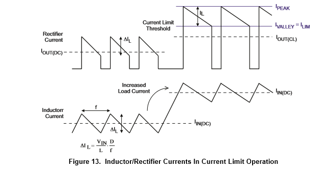

How TPS61256x implement output short/over current protection?
  • When the load current increase , and makes the valley current touches the current limit value, the output volatge will drop. When the output current further increase, and makes the volatge further drop to a very low value, both the high side FET and the low side FET off.
  • Hi Helen
    Could you explain it in more detail ? thanks
    Datasheet :“ When the load current is increased such that the lower peak is above the current limit threshold, the off-time is increased to allow the current to decrease to this threshold before the next on-time begins (so called frequency fold-back mechanism). When the current limit is reached the output voltage decreases during further load increase ”
    It seems IC no limited the current, just detect the valley current, if valley current exceeds the Current Limit Threshold(Typical 2.4A) ,then extend the off-time but on-time is constant to limit the Average current ,but Ipeak dosen't limited ? Ipeak  is defined by the on-time and the inductance,based on the VIN/VOUT ratio, a simple circuit predicts the required on-time.so how to calculated ON-TIME ?
  • Peak current is limited by the Vin, inductance, and Ton. Ton is determined by the Vin and Vo(the IC sample the Vin, Vo value and calculates it). When the IC enters into the current limit condition, Vo begin drop, then Ton will also drop. So you need't worried about the Ipeak.
  • Hi Helen
    1、So you mean the Ton is  inversely proportional to Vout ? Could you give the Ton 's Equation?
    2、In my understanding: when in Current Limit Operation, Ipeak=I valley + Vin*Ton/L,(I valley=2.4A typ) , is right? so how to calculate Ton?
  • Yes, Ton is inversely proportional to Vout. it calculates by Ton=Ts *(1-Vin/Vo)
  • Hi Helen
    According to Ton=Ts*(1-Vin/Vo)  ; Ton is direct proportional to Vout , not inversely proportion
  • Yes, you're right. When Vout is lower, Ton is lower.
