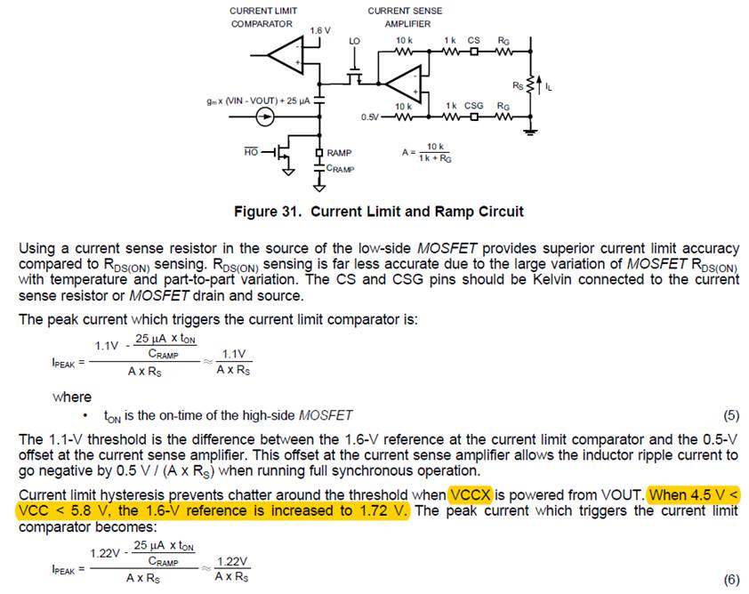

Please answer the question from customer.
As yellow part. When VCCX=12V, the reference voltage is 1.6V or 1.72V?
