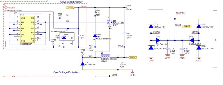

Hi support team champs:
My customer is designing a 1800W 400VDC to 115V DC/DC converter based on UCC28950. They are using full-bridge SR rectification configuration but wishes to reduce the rating for the SR FETs, which they add the active buck snubber circuit like PMP6712 or as shown below:
In such condition, can they chose 250V FET for their application? The X'FMR turns ratio is 2.5:1 for Np:Ns.
(400V/2.5=160V + 75V spike)
Thank you.
