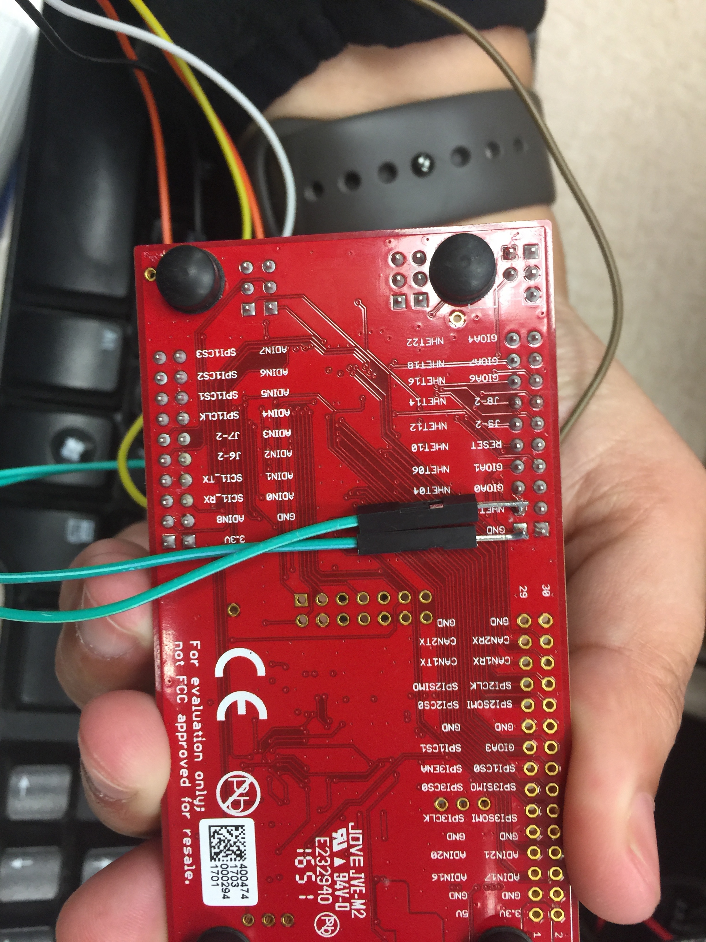

  • Hi Mr. Weist,
    When I connected the  TMS570 to the white UART header and connected the cells to power the PL455 I recieved this error.
    Also if it is suspected that one of the R pins (that is, pin 38 and pin 39) is damaged how may that be verified?
    Elda
  • Hi Elda,
    I think if one of those pins are damaged, then you certainly could see an incorrect CRC.
    You may be able to use an ohm-meter or continuity function to detect a gross short. If you have access to a thermal camera, you may be able to see increased current consumption in the form of higher temperature than a good unit.
    Of course, if you have a separate launchpad the easiest way to diagnose it is a swap test with a new launchpad.
