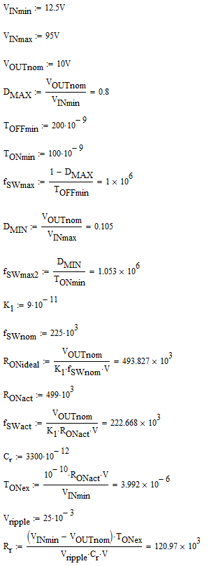

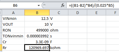

Equation 16 in the first application example (page 17) states that the maximum ripple resistor is calculated to be 57.6 kohm. However, when using the values provided earlier in the example, I come up with 121 kohm:
When using the LM5017-QUICKSTART-CALC and the application example's conditions (VINmin = 12.5V), I get 134.99 kohm, but I can't see the equation for the locked cell (F53), so I'm not sure how that is being generated either.
Can you help me understand where 57.6 kohm in the datasheet comes from, how the quickstart calculator comes out to 135 kohm, and which one is right?

    My understanding is that it's the same equation, just a different target ripple voltage spec or input voltage condition. The larger resistor will provide a lower ripple amplitude at FB, and you should verify circuit operation and stability at minimum input voltage (lowest ripple operating point).

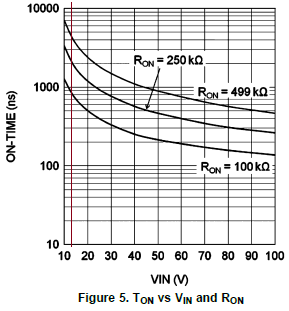

    The datasheet equation specifies 25 mV in equation 16, and my calculations use the same VIN, so the only difference must be in the T_ON(VINMIN) parameter. Looking at Figure 5, a TON of ~4 us seems reasonable for RON = 499 kohm and VIN = 12.5V:

    Sorry for the double post. I cracked the spreadsheet calculator, and found a few inconsistencies between the datasheet and the calculator's constants:
    Note the minimum on time is 125 ns instead of 100 ns, and K = 1*10^-10 instead of 9*10^-11.
    Do you know which value should be used - 100/125 ns, 1*10^-10/9*10^-11?
    Jonathan
  • Hi Jonathan,
    I will confirm. In the meantime, take the datasheet parameters for Ton-min and K as correct.
