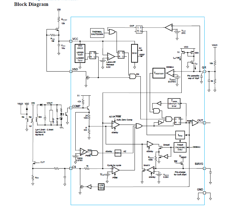

Our customer is during H/W debug for isolated DC/DC. That controller is LM5023.
During rated load output, Ton momentarily goes low after 13-usec from the start and then keeps high after that.
I found the parameter tRESTART.
What is tRESTART?
This device can't output FET-High continuously?
How long time the max value of tON ?
Is this device can' t use for High-current power supply? (Low fsw , Heavy Primary inductance transformer , and wide tON)
