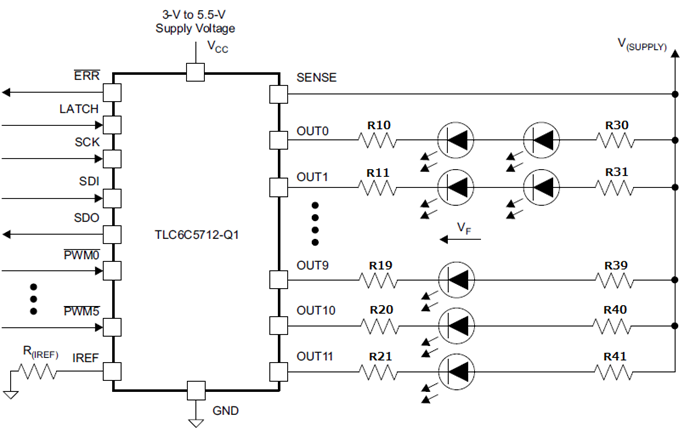

I am considering a circuit using the device of TLC6C5712-Q1.
So, I would like to ask about using this device.
Even if the number of LEDs is different as shown below, if the following formula is satisfied, will the current set in the LED flow?
V(supply) - Vresistor - (Vled + Vled) > 0.75(V)
