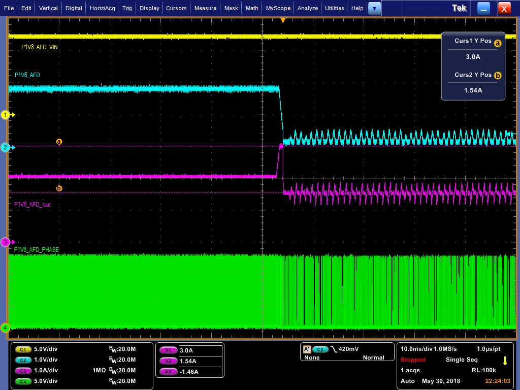

I'm using TPS62140A on my non-isolated DCDC converter design and found a strange waveform while performing OCP test.
I found the Vout was bouncing and got some reverse current on Iout though it was clamped at 1.6A, is it a normal waveform?
Vin = 12V
Vput = 1.8V
Fsw = 1.25MHz
Lo = 3.3uH
Cout = 47uF * 2 (MLCC)
  • Hi Stan,
    It's not clear what is wrong with this waveform. You likely have an electronic load and a long length of cable from the output to the load. This inductance and active load can create all sorts of waveforms.
