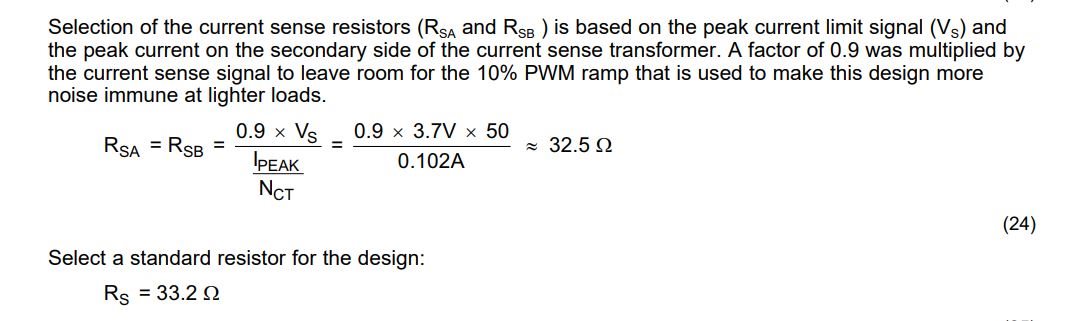

You can calculate the RIMO value based on a modification of Equation 17 in the datasheet
The factor Iin(pk)*(Rs/Nct) in this equation is actually the max output voltage of the CT so you can replace this with the peak output voltage of your OPAMP.
Normally you would set this at about 3.6V to get the max range of the CSA,CSB inputs
The value of RSYNTH can be calculated from Equation 12 by noting that Rs/Nct is actually the load resistance seen at the primary side of the CT.
So you can replace Rs/Nct by the value of the current sense resistor (Rs) used on the source of the boost MOSFET.
This is the response of your but i want to know if the unit of sense resistor Rs is ohm or mili-ohm?

    I would like to point you to the application note of UCC28070 (section 6) which will talk in depth about  how the calculations are done and the units of each component.
    Also, the link to the application note:

    I don't use a current transfomer but a shunt resistor. one of your colleague gave me the following response to calculate IMO SYNTH resistor :
    Currently my question is to know if the unit of shunt resistor to perform calculation is ohm or mili-ohm.
