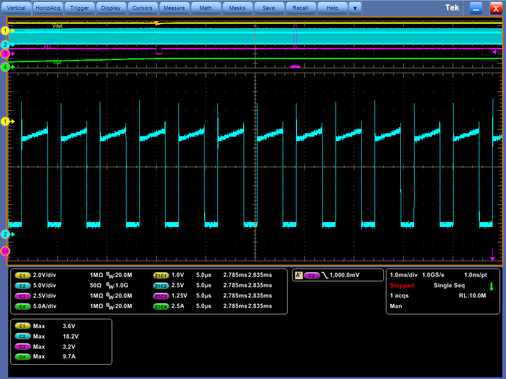

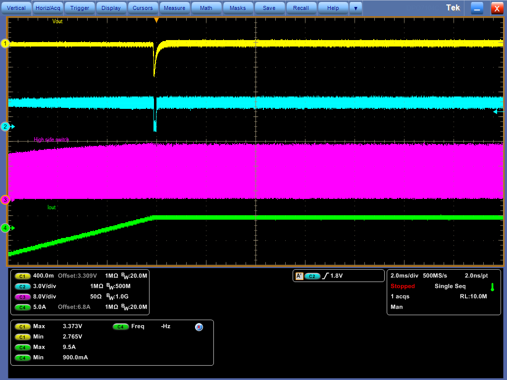

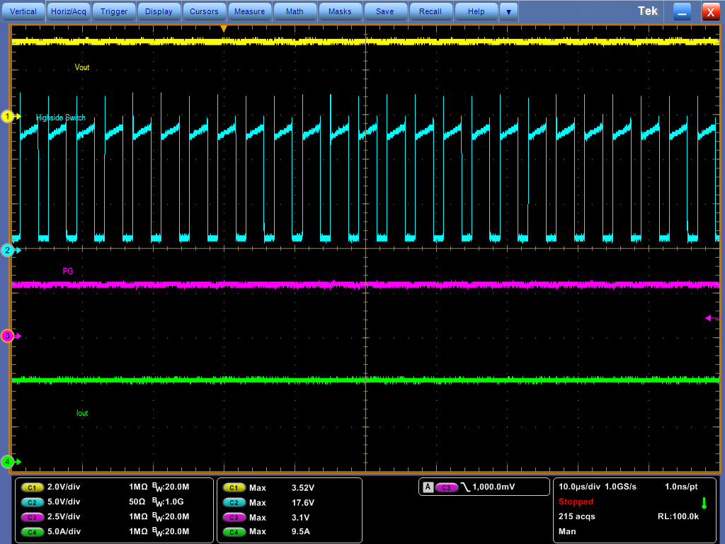

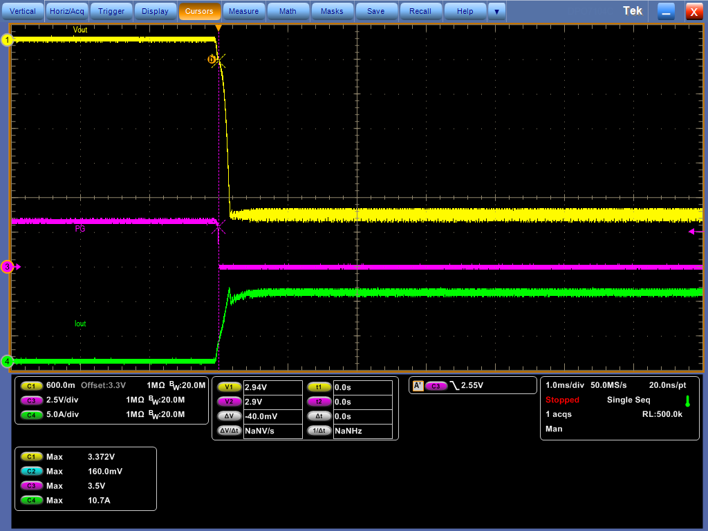

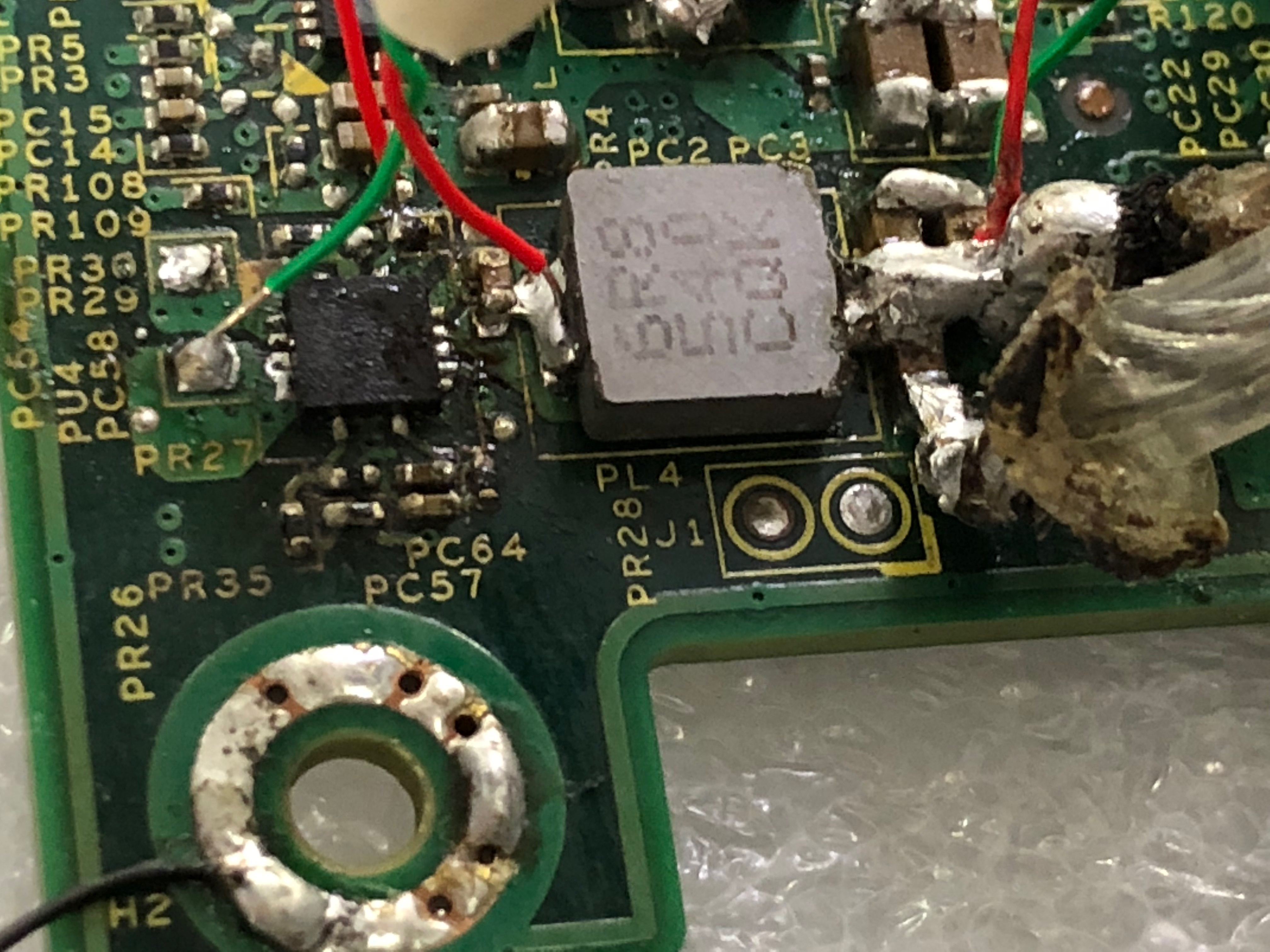

My customer had hard short test by using Electrical loading and captured the attached waveform. The waveform shows Vout starts drop ta the very begining even the Iout still under 6A. Why the behavor Vout drops before Iout reach 6A? Another test, customer used the constant current mode to increase the Iout loading and Vout started drop at Iout 9~10A.
