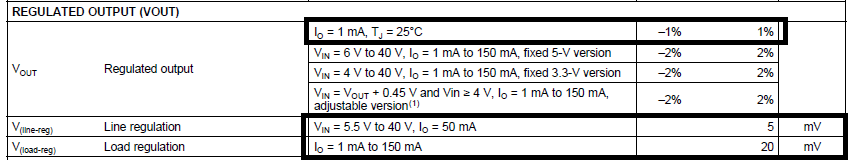

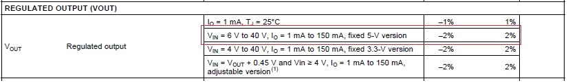

Below spec is under from -40C to 150C.
Could you let me know the spec under same condition with room temp?
Is it +/-1%?
Thanks.
Is it +/-1%?
Thanks.
Hi David,
It will be between +/- 1% and +/- 1.5%:
To estimate regulated output spec at room temp with Vin = 6 V to 40 V, Io = 1 mA to 150 mA, Take the Io = 1 mA, Tj = 25°C spec and the line and load regulation specs. The load and line regulation specs add up to 0.5% and are max over temperature. This gives a +/- 1.5% which is upper limit of the spec you are asking for. Lower limit is +/- 1% at a single load current 1 mA and 25°C.
