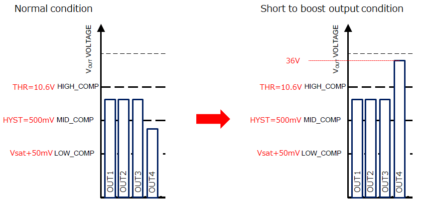

  • Hi, Thank you for your support. We would like to make sure one thing. If LED short is occurred under the following condition, will the short protection be active?
    1. The voltage of 3 strings is between MID_COMP and HIGH_CPMP and the other one is between LOW_COMP and MID_COMP.
    2. OUTx is shorted to FB pin(BOOST output). *Please refer to below figure.
    If the short protection will not be active under this condition, is there any possibility to damage the current sink(OUTx)?
    tateo
    For case 1, no fault will be triggered as one string headroom is normal and other 3 strings are lower than high comp.
    For case 2, LED short fault will be triggered and if short is hard(voltage slew eate is very fast) , OUTx pin may be damaged. Small cap between OUTx and GND will slow down slew rate and prevent the potential damage. But in usual cases, this cap is not used.

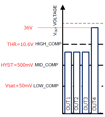

  • Hi, Thank you for your reply. Sorry to bother you again. Let me confirm one thing.
    If the LED short condition as shown below figure is occurred in display mode, will the LED short protection be active?
    According to datasheet, in display mode, the trigger of short protection is if one or more outputs voltage is above DRV_LED_FAULT_THR and at least one LED output voltage is between DRV_HEADR and DRV_HEADR + DRV_LED_COMP_HYST. So they think the short protection will not active under the consition that the voltage of 3 strings is between MID_COMP and HIGH_COMP and the other one is over HIGH_COMP(ex. short to Boost output). Is their understanding correct?
    tateo
  • In this case, boost voltage is adjusted to make headroom voltage of at least one  string between low and mid comparator first, then LED short dault can be triggered if highest headroom is still higher than high comparator. If every string headroom is higher than low comparator, no faults can be detected right away.
