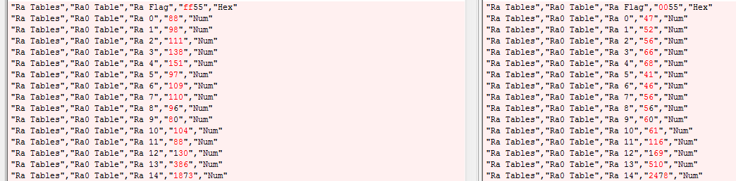

I have a 8S10P (28.8V 26Ahr) pack with a bq34z100.  I tried to follow the documentation but some of the terminology doesn't seem to match bqstudio 1.3.80.  Is "UPDATE_STATUS" now "LEARNED_STATUS"?  The RUP_DIS, VOK, aand QEN all seem to behave correctly.  The LEARNED_STATUS was 4 at the start, 4 during charge, 5 during discharge, and 6 once VOK was green again.  I never saw any updates to the RA tables at any time.  I was discharging at C/5 (5 amps).  I use the manufactures recommendation of chemistry selection Samsung ICR18560-26H.  Attached are the log files.  I'm sure I missed a setting.
