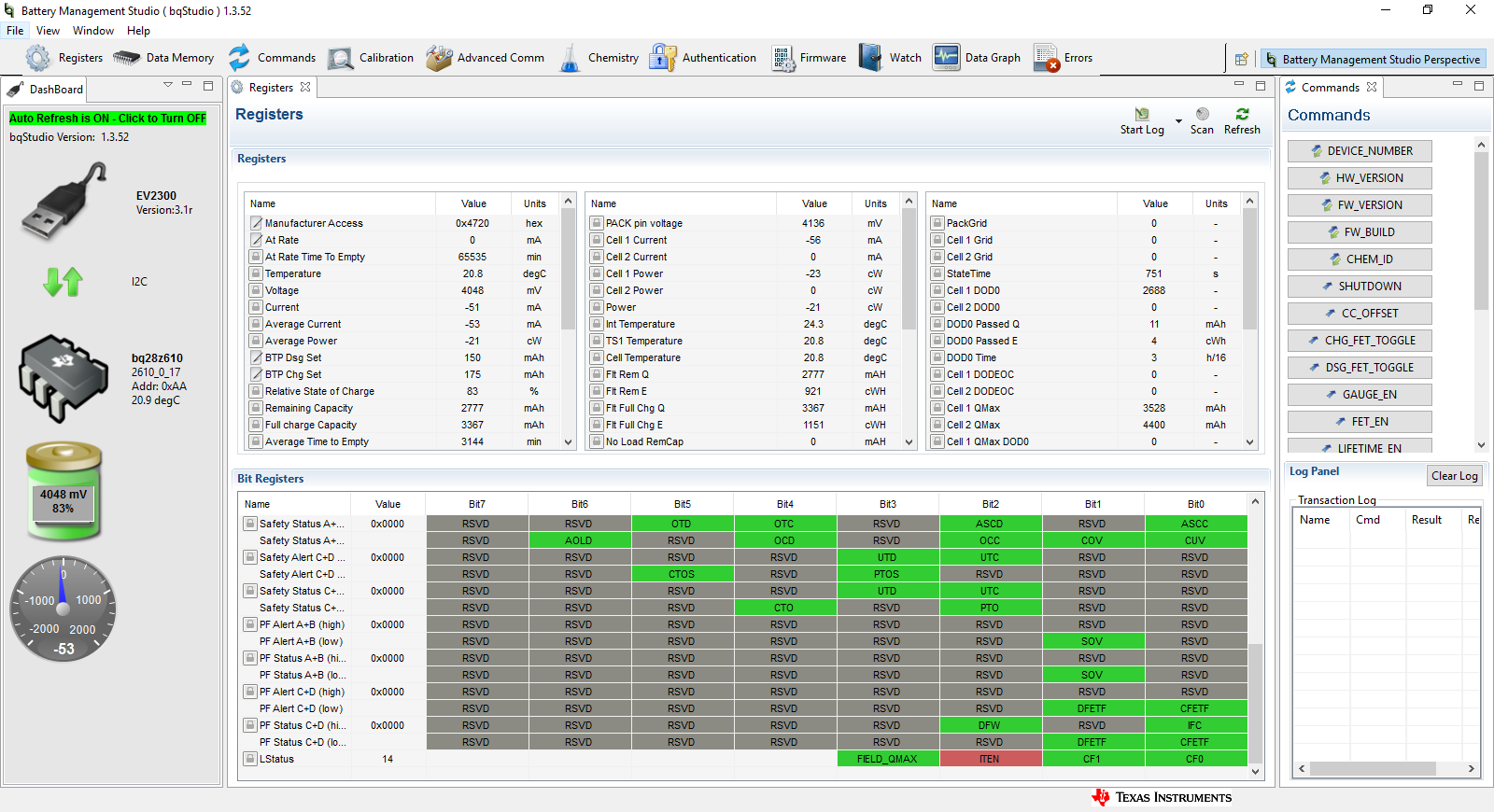

My question is about the cycle count parameter not incrementing. I am running a bq28z610 fuel gauge in 1S mode. I have fully charged a cell, passing through the cycle count percentage (which I have set to 90%), and discharged the cell below 90%. However, the cycle count does not increment. According to the TRM, the cycle count state is defined as follows in 13.6.10:
As previously stated, cycle count percentage has been set to 90%. I have passed through this threshold in both directions (charge/discharge) with no effect on the cycle count. Is there something else the cycle count is dependent upon that the fuel gauge is looking for?
    Have you enabled IT? The thresholds are based off your design capacity. So, please make sure that is consistent with Qmax and FCC.
  • Hi Batt,

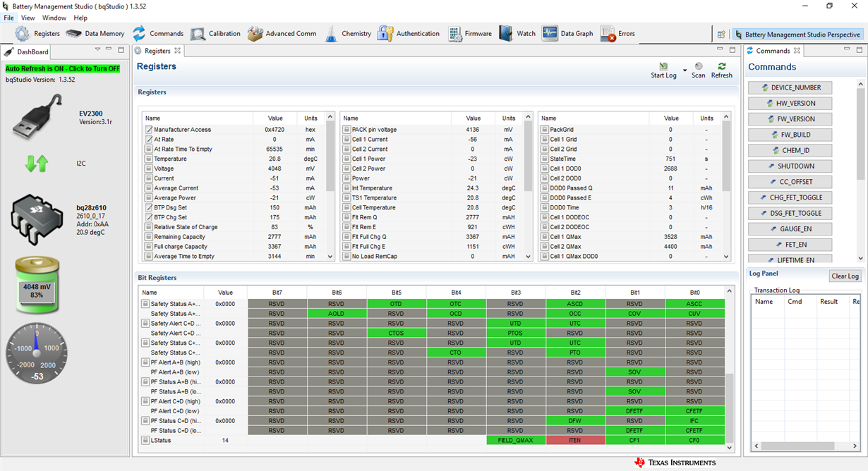

    Thank you for the suggestion. I can confirm that ITEN was enabled during the cycle test, as seen below:
    I ran another charge on the cell but the cycle count did not update.
    The most recent FCC is 3353mAh. The Design Capacity is 3500mAh. The CCT bit is configured as 0 (using Design Capacity by default).
    Could you explain what you mean by "make sure that is consistent with Qmax and FCC"?
  • Note that Cycle Count Percentage isn't a threshold that you pass to have it counted as a cycle, it is the amount of charge that needs to be passed to have it count.  So if you have it set to 90%, you need to discharge from 100% to <10%, for example.
    Terry
  • Yep, I was thinking about it differently. I changed the percentage and retested with success. Thank you Terry.
