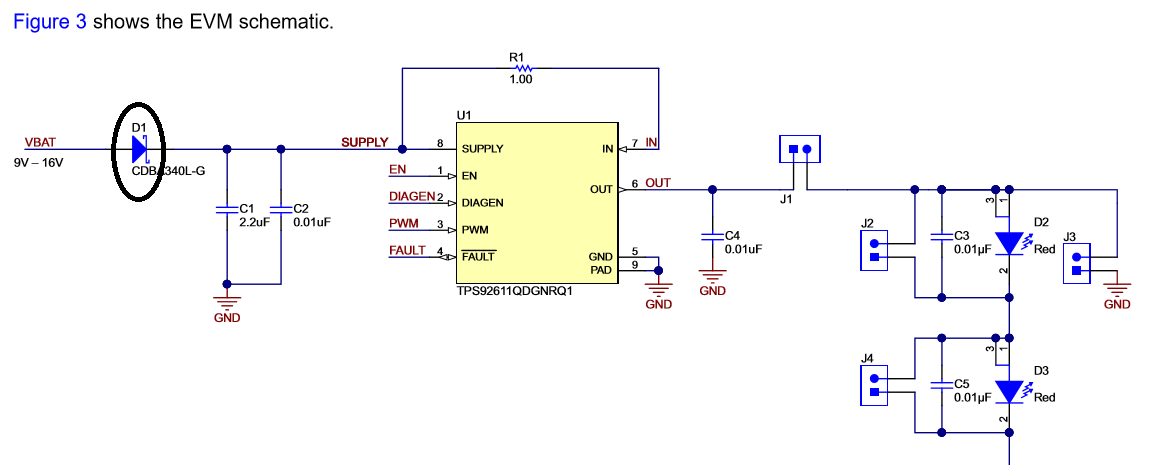

Regarding EVM schematic, D1 is mounted it on.
We can see the diode on the reference schematic on datasheet.
I wonder what is the purpose of D1 Diode?
Is it for reverse battery protection?
Don't need mount if such protection was not needed?
Please give your advice.
H. Sakai
  • Hi Hideyuki,
    Yes you are right. This diode is for reverse battery protection.
    Shirley He

    The LED on output is just 1 series & 1 parallel. The series resistor will be inserted in
    series with LED considering the power dissipation(heating) division between
    TPS92611-Q1 & LED.
    In addition, the SUPPLY voltage will be sightly down due to cold-cranking.
    They don't expect the normal(proper) current regulation during such phase.

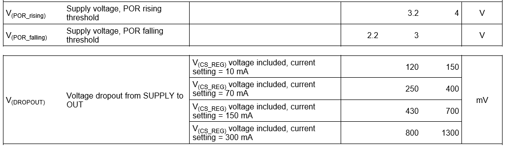

    1. Vpor_rising = max. 4V. What kind of behavior will be observed on TPS92611-Q1
        at SUPPLY voltage range 4.0V to 4.5V?
        Will TPS92611-Q1 continue the operation without normal(proper) current regulation?
    2. If SUPPLY voltage is higher enough than 4.5V, but could not maintain enough Vdropout.
        Will PS92611-Q1 continue the operation without normal(proper) current regulation?

  • Hi Sakai-san,
