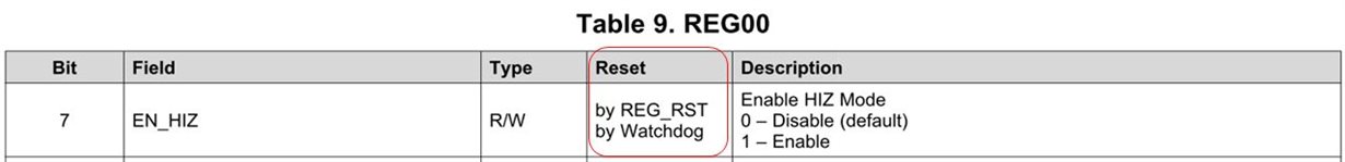

BQ25898: bq25898 / EN_HIZ bit reset condition
Part Number: BQ25898
Please let me ask EN_HIZ bit reset condition. I actually confirmed that the the EN_HIZ bit is reset by plugged in VBUS at EVM. I'd like to know if this behavior is expected because the VBUS plugging is not listed in Reset condition of EN_HIZ bit.
Satoshi / Japan Disty
  • Hi Satoshi-san,
    Our chargers automatically go into HiZ when VBUS is removed and they automatically exit HiZ when VBUS is plugged in. The register table Reset column was intended to explain how firmware controls the bit.
