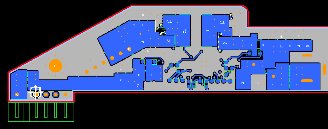

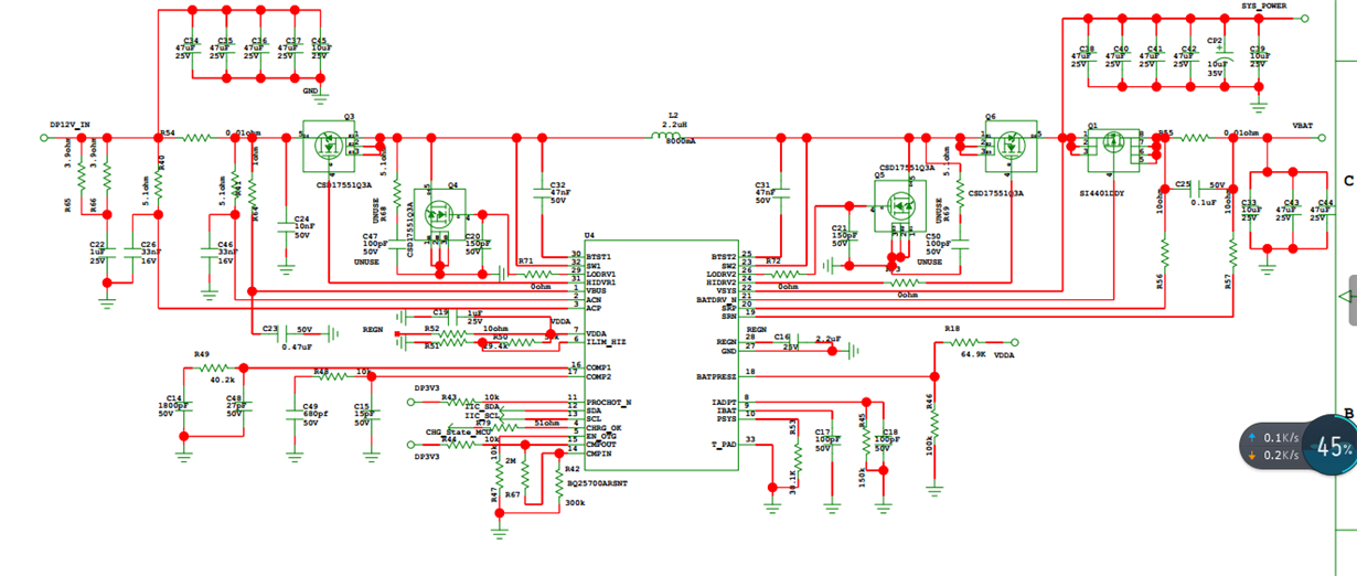

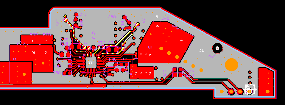

The copper in the inductor and inductor range  generate heat seriously! According to the preliminary testing,the temperature can reach to 60℃ work for 30 minutes.my charging current is 1.3A,the inductor value is 2.2uH.The schematic is as below:
The PCB design is based on the BQ25700EVM, and the trace width is 80mil.could you help me to locate the caouse of heat generation?

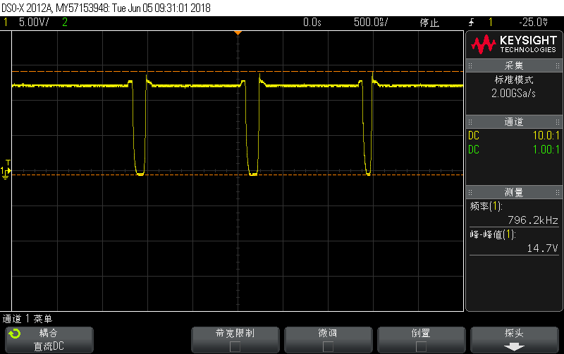

In addition, Why is the switching signal waveform not a square wave?

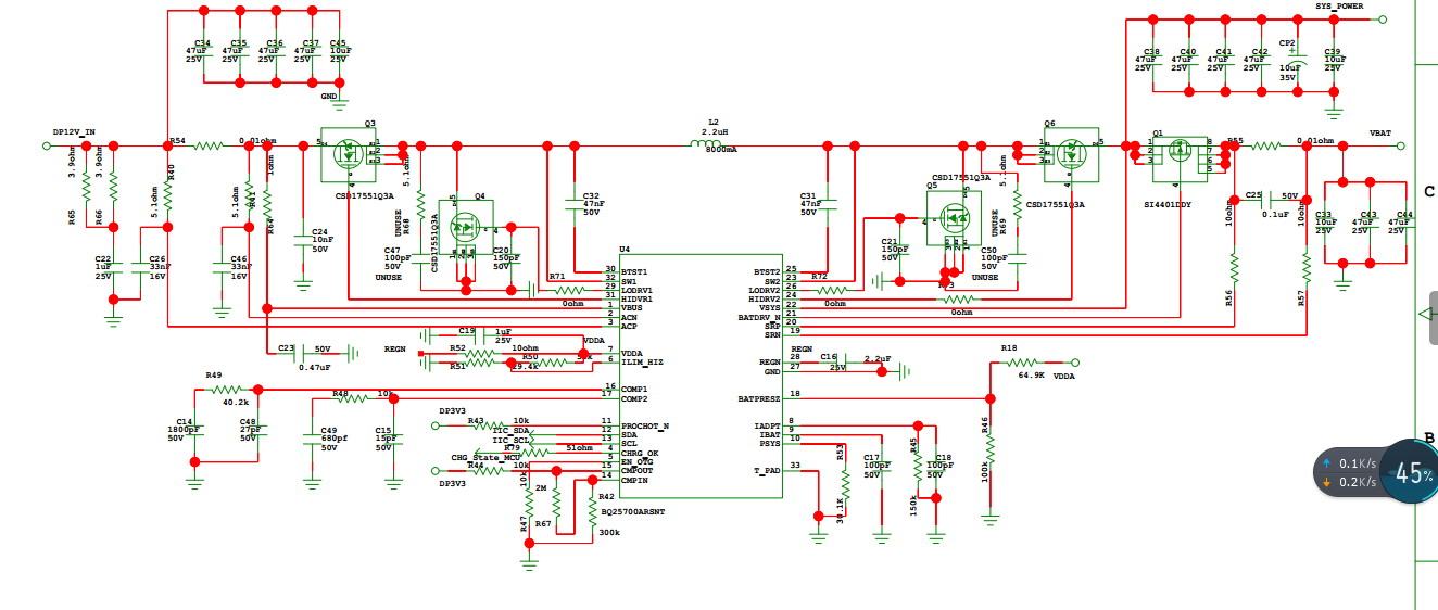

  • Yan,
    91% efficiency with 12Vin and 12Vsys is low.
    R45 should be 137kohm for 2.2uH inductor, not 150kHz. The IADPT pin resistor indicates the inductor value.
    Do you measure SW1 or SW2?
    Can you zoom out the switching node waveform? I want to know it is PFM or PWM.
    Can you also zoom in the switching node to find falling and rising edge timing with 1.3A load? I hope the falling time and  rising time can be less than 20ns.
    For the same condition, what is the EVM efficiency?
  • Li
       I have measured the EVM(BQ25700EVM-732) efficiency under the same condition(VSYS 12V, E-load 0.1A to 1.5A).The results are as below.
       I have also captured the switching node waveform of both the EVM and my layout. Results are in the file inserted. But I have no idea if you can download the file. According to the waveform,the rising or falling edge time of my layout doubled(or even worse) comparing with the EVM. Besides,the SW2\LODRV2\HIDRV2 node waveform is not square wave.
       Thanks for the advice. I have already changed the R45 to 137K. Looking forward to your reply.

  • Yan,
    The switching waveforms are slow from your board. That could cause the efficiency low. For such small current application, we may select a lower Cg with 20mohm Rds_on FET to improve the efficiency.

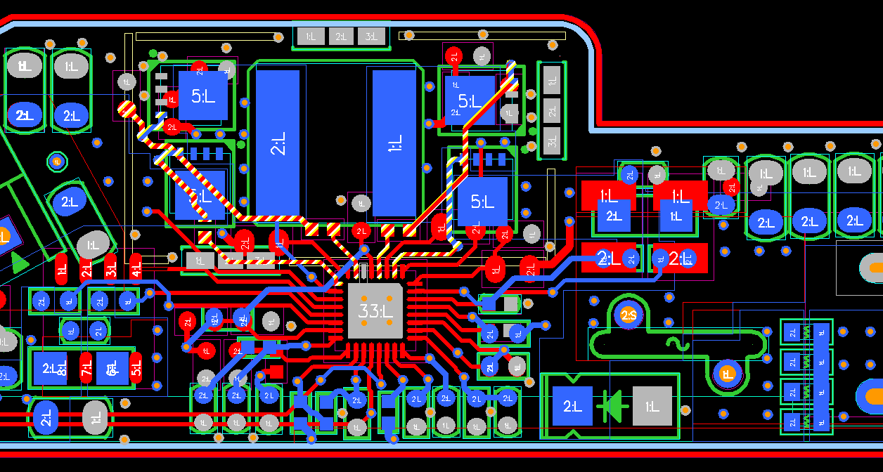

    The highlighted lines are the switch node signal on my board(the resistances in series with the switching node signal are 0 ohm.), as shown in the pictures below. Does my layout have such great influence on the switching node signal?What else factors could have influence on the rising\falling edge of  the signal?
    Thanks! Looking forward to your reply.
    Zhang Yan
  • Yan,
    Is it 2 layer board? Actually, I couldn't tell anything wrong on the layout. I used 4 layer board to do the EVM. It is hard to use 4 layer layout experience to guide 2 layer board layout.
