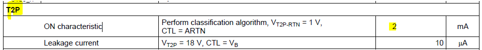

I see the IT2P minimum is 2mA.

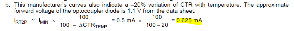

But in dataaheet P.33, the finally calculate value is 0.625mA
Is it OK for this design? Does The minimum valus need to 2mA for IT2P?

Hi Julian,
The ON spec is really showing the RDSon characteristic of the T2P internal FET (Very low). So operating at a lower current like shown is okay. Since this is a logic signal, the key design consideration is that the opto output goes LOW enough such that the load can recognize that a Type 2 PSE is connected.
Or you can look at the TPS23754EVM-420 below and see how its implemented. You can measure TP4 performance.
Dear Darwin,
Thanks for your reply.
So, does your means that RDSon maximum = 1/2mA(min)=500R?
