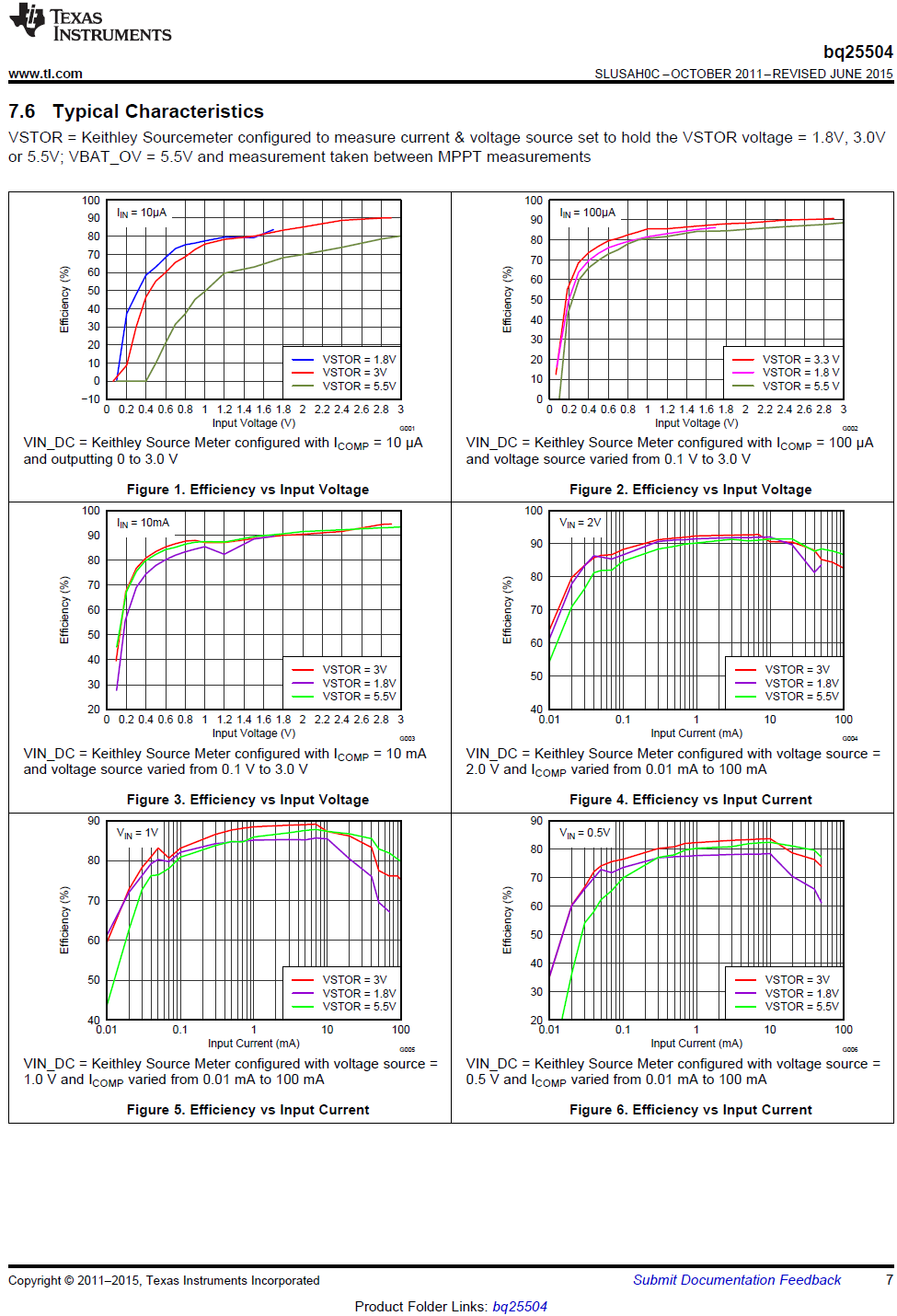

Below is BQ25504 efficiency graph from document page 7.
I would like to ask followings:
Q1. For those graphs, what is the load resistance?
Q2. For figure 1, how do you set voltage of VSTOR to be 1.8 or 3 or 5.5V? By setting OV resistor values?
Thank you.
