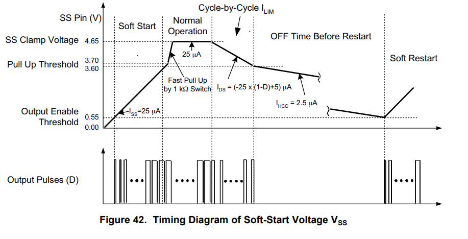

Hello team,
My client have some question about the soft-start of UCC28950. When the Vss is over threshold 3.6v , Vss fast pulls up to clamp voltage.
They want to know how to prevent enter into normal operation region. So as not to trigger the OCP of the system.
