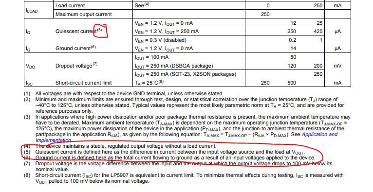

Hi expert,
My customer wants to know the Iq on LP5907(Vout is on but no load). I saw the spec on datasheet(Iq=25uA max.) but I want to double confirm if this Iq includes everything(internal circuit power dissipation, voltage divider on Vout...etc.) and it is measured from Vin? Thanks a lot!
