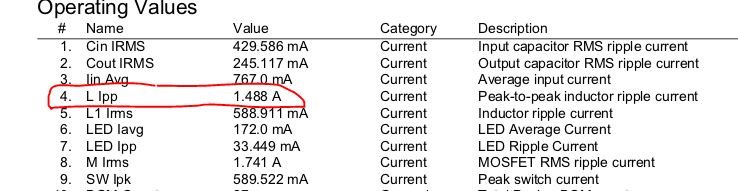

I am not able to match webench design result with datasheet calculation.
If Inductor p-p current is calculated from datasheet section 8.1.2, it is much lesser than webench results.
Input & output parameter are given in attached pdf.6114.WebenchReportsServlet6V-36V.pdf
