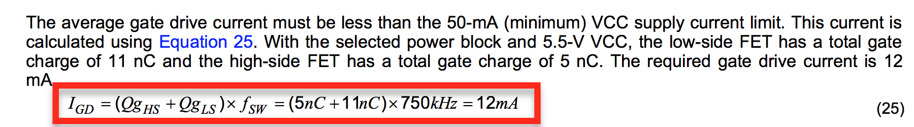

Hi, All:
As below picture that show IGD must less 50mA.
I have a issue after run webench as below file.webench_design_2047837_188_675151061.pdf
I Calculate IGD is over than 50mA, Is it ok??
If yes, May I choose a MOSFET that Qg = 42nC and used for high & low side MOSFET?
