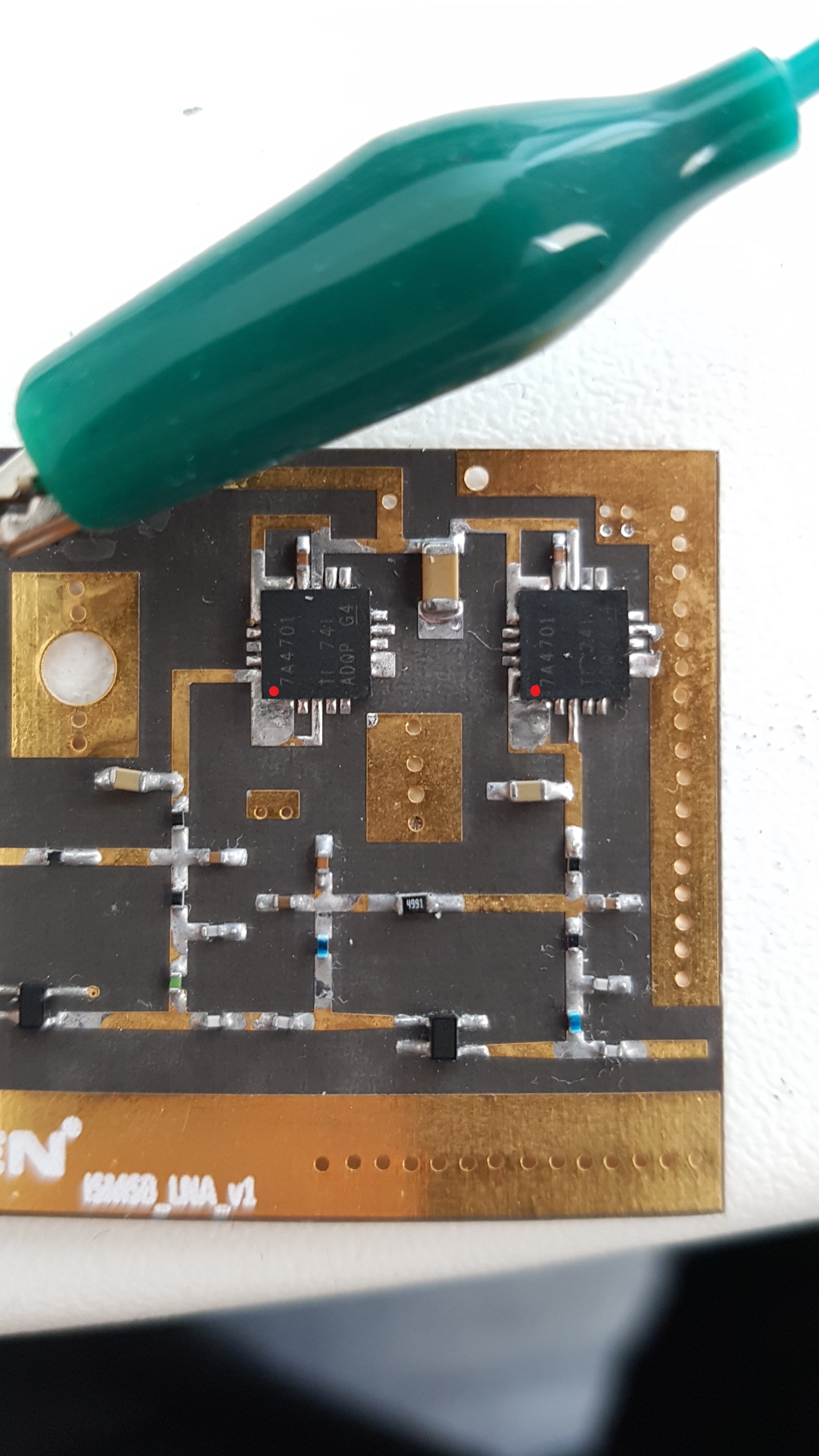

I was designing an LNA and needed 4V at output of the LDO.I used tps7a4701 for the regulator and used any-out option for setting up the output voltage.But I get a variable output when I power up the  circuit. At Vin=3V I get Vout=3V and when i increase Vin Vout increases. Vout caps around  5.42V. You can check the design below.
    could be a soldering issue. There's a bit too much soldering tin on the solder pads and many lints can be seen. Are you sure that there's no short circuit? What says the ohmmeter?

    It is somewhat difficult to tell from your picture which of the ANYOUT pins you have tied to GND; however, it looks to me that you tied 3P2V to GND as well as 0P8V.  Unfortunately this will yield a nominal output of 5.4 V when the LDO has a high enough Vin to regulate.
    In order to achieve the intended 4 V output, tie pin 8, pin 9, and pin 11 to GND.  4 V = 1.4 V (Vref) + 1.6 V + 0.8 V + 0.2 V.

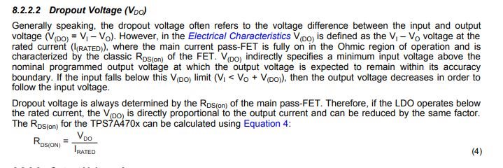

    When Vin is lower than 4 V + Vdo, the LDO will operate in dropout mode.  While in dropout, the LDO does not have enough headroom (Vin - Vout) to regulate the output voltage and the output will follow the input voltage minus a small resistive drop in voltage.
    Please note that we also highly recommend having a same layer GND path for all bypass capacitors to the LDO GND pin in order to cut down on inductance.  This is particularly critical for Cout.
