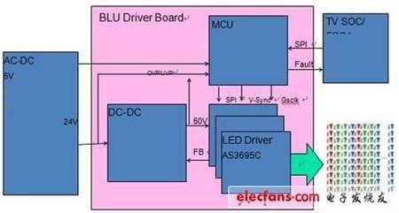

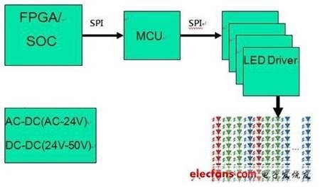

The loacl dimming scheme based on MCU consists of three parts: FPGA or SOC, MCU and LED Driver IC.
SOC collect image signals and send data to MCU through SPI interface.
After data processing, MCU controls one or more LED drivers through SPI.
