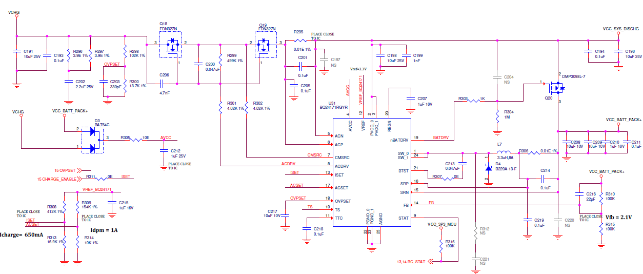

I am facing an issue when using BQ24171 with 12V input and single cell 4.2V battery.
When System output switches from Battery power to input DC power or from input DC power to battery power, there is a voltage dip occurs and causes the system to reset.
When switching from input DC to Battery, the system voltage stays at 3V for 8ms, Attached scope shot for voltage at ACDRV, BATDRV, and Vsys(system voltage) when switching from DC to battery.
When switching from Battery to input DC, the system voltage stays at 3V for 1.5ms. Attached scope shot for voltage at ACDRV, BATDRV, and Vsys(system voltage) when switching from battery to DC.
