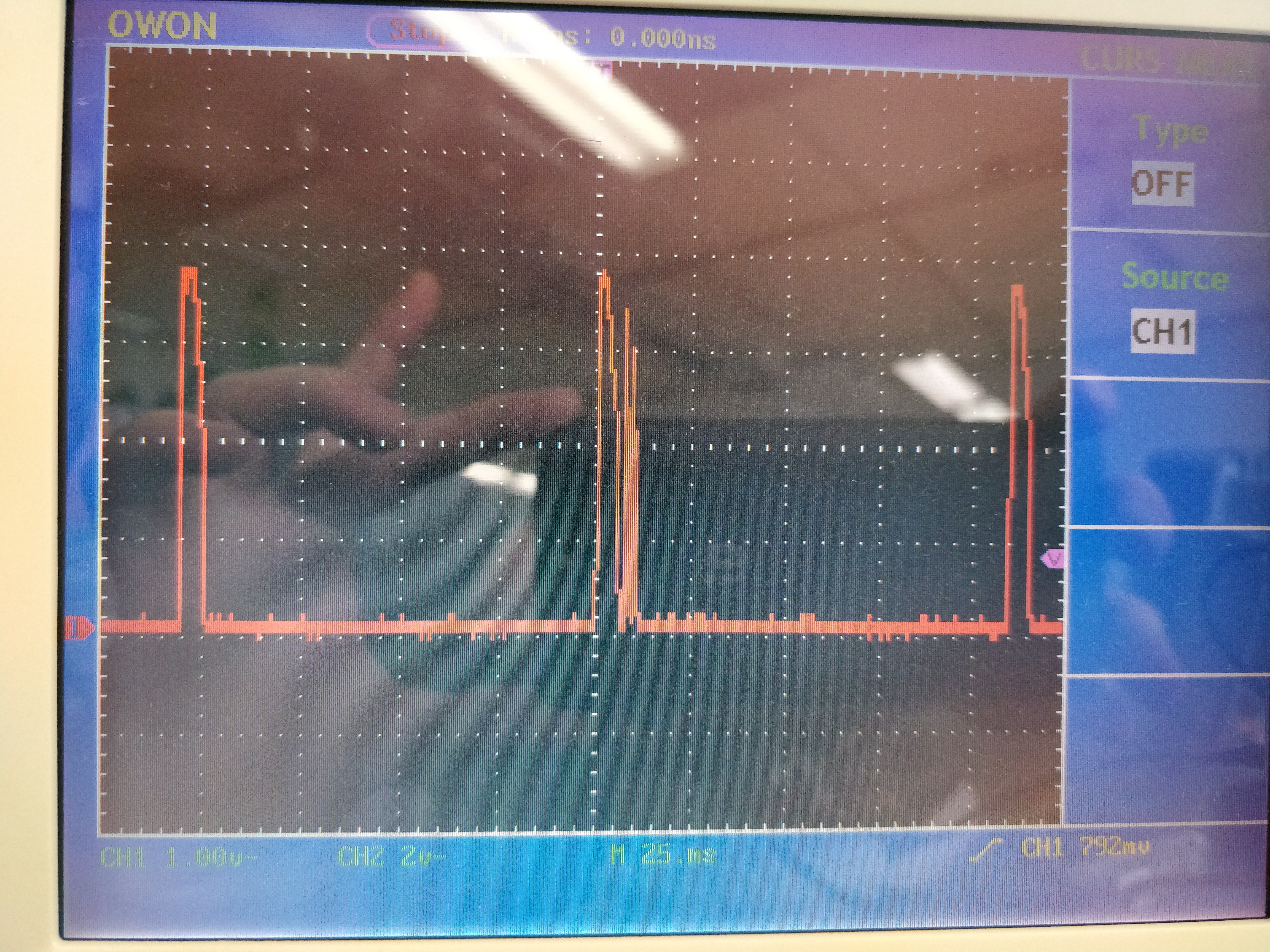

We plugged a power supply at 4V instead of batteries at +VBAT/-VBAT, and the power supply's display toggled constantly between 0 and 4V. I checked the output of the charger on a scope and it looks like the charger tries to start, fails, then tries again 100ms later (I will try to attach a picture). Again, this PCB worked really well before the problem.

  • Here is a picture of the charger's output when connected to a power supply at 4V.
  • I've cut the trace that connected V_CHARGER_OUT to our buck/boost's input (TPS63070), and connected our power supply directly to the TPS63070, and there was clearly a short. I reapplied 4V at the input of the charger and its output was a clean 4V also, so the charger seems to be doing its job (going in overcurrent protection).

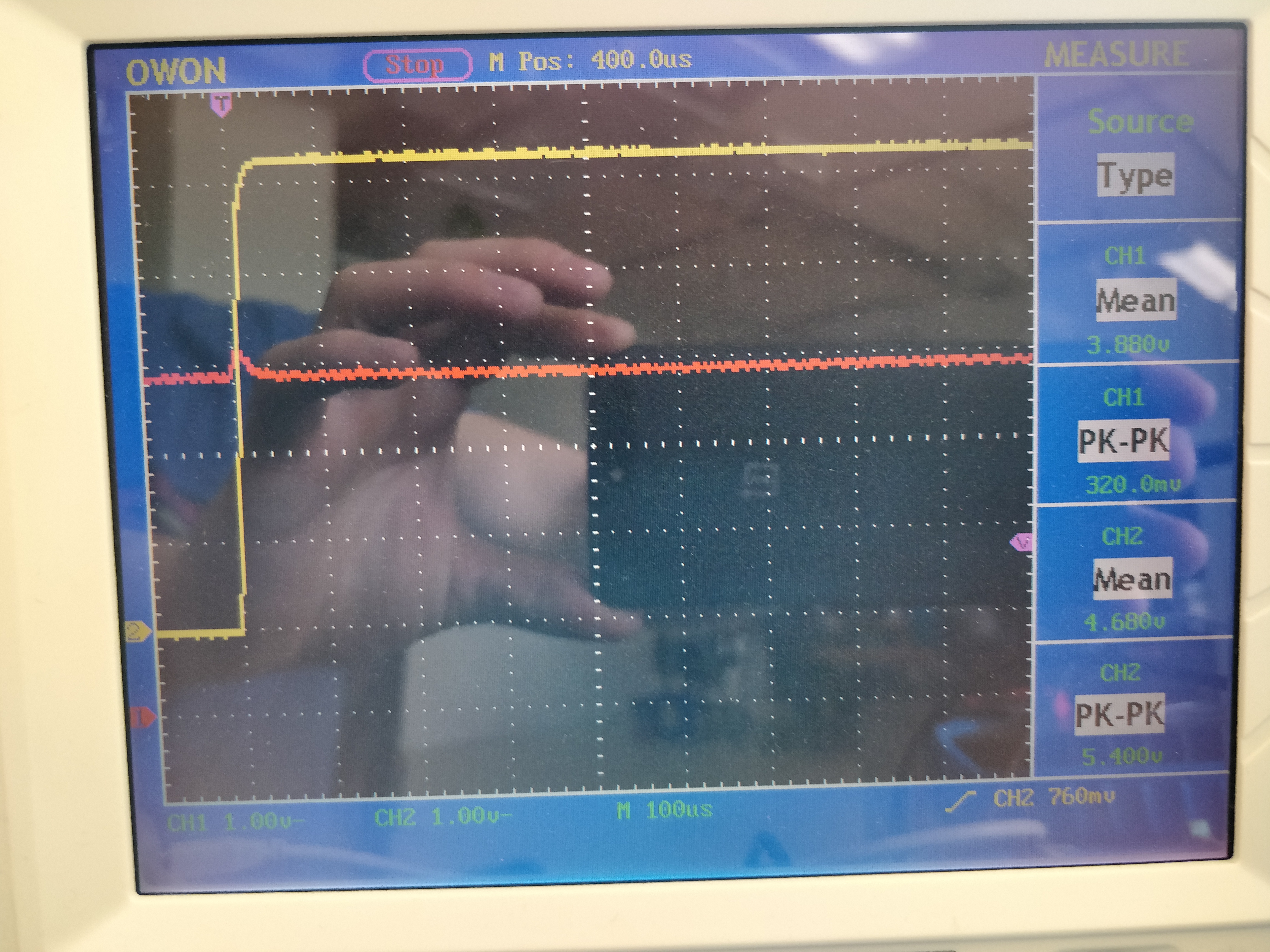

    For the curves that you wanted, I got two:
    1 - 100 us/div; Channel 1 (red) = V_SYS, 1 V/div, Channel 2 (yellow) = VBUS on a USB connection, 1 V/div
    2 - 100 us/div; Channel 1 (red) = VBUS current (on a 0.12 Ohm Rsense), 200 mV/div, Channel 2 (yellow) VBUS on a USB connection, 1 V/div
    On the first curve, you can see that VSYS has a peak of ~320 mV when connecting the USB.
    On the second curve, you can see a surge of current when the USB is plugged. The Rsense is 120 mOhms, and the scale is 200 mV/division, which gives a peak current of 5.6 amps! Is this normal? Our ILIM resistor is 536 Ohms, which should give a current limit of 478/536 = 891 mA, and our ICHG resistor is 680 Ohms, which should give 677/680 = 996 mA.
    Now, there is an IC on the board which we only power when there is a USB connection detected, because it can consume quite a bit. For the curves above, I didn't power the IC. I then tried the same test but by powering the IC on a USB connection, and the charger failed again. Could the BQ25606 be burnt by the extra current required by the IC coupled with the sudden current rush on a USB connection? I don't have a curve for this test, as my scope did not trigger.

    I was looking at your two waveforms, and I cannot see why there is a difference in the VBUS waveform. It looks like all you added between waveform 1 and 2 was a sense resistor, but for some reason VBUS has a small 400mV spike on the input voltage in waveform 2. Is there something else different between your two test setups?
    Secondly, are both waveforms taken on a non-damaged board? The second waveform looks to me like inrush current into the caps rather than the charger, but the pulse lasts quite a long time relative to the capacitances.
