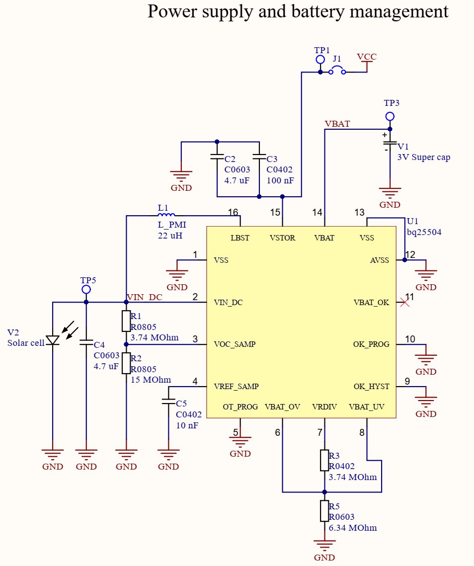

Hello
In a Project i want to supply my circuit with a supercapacitor with a voltage of 3V and a capacitance of 1F. I have a solar cell with an Voc = 0.9V.
This part in the circuit Looks like that:
When i do not mount the supercap i can measure the voltage VBat = VStor = 3V. So this is ok.
But when I connect the supercap, the voltage of the solar cell goes very low, and the supercap only charges a bit.
Do anybody know this issue? Where is the Problem?
