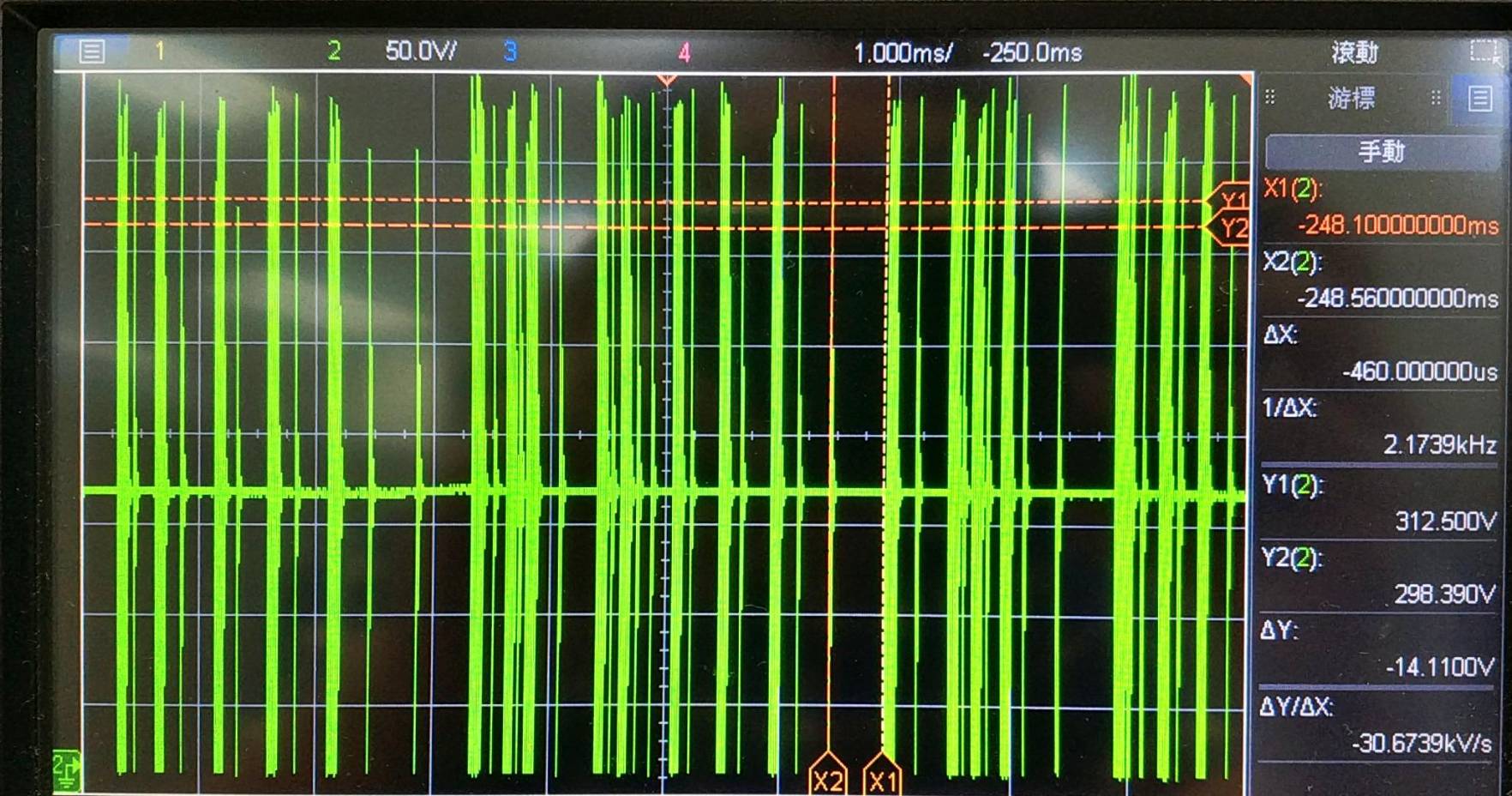

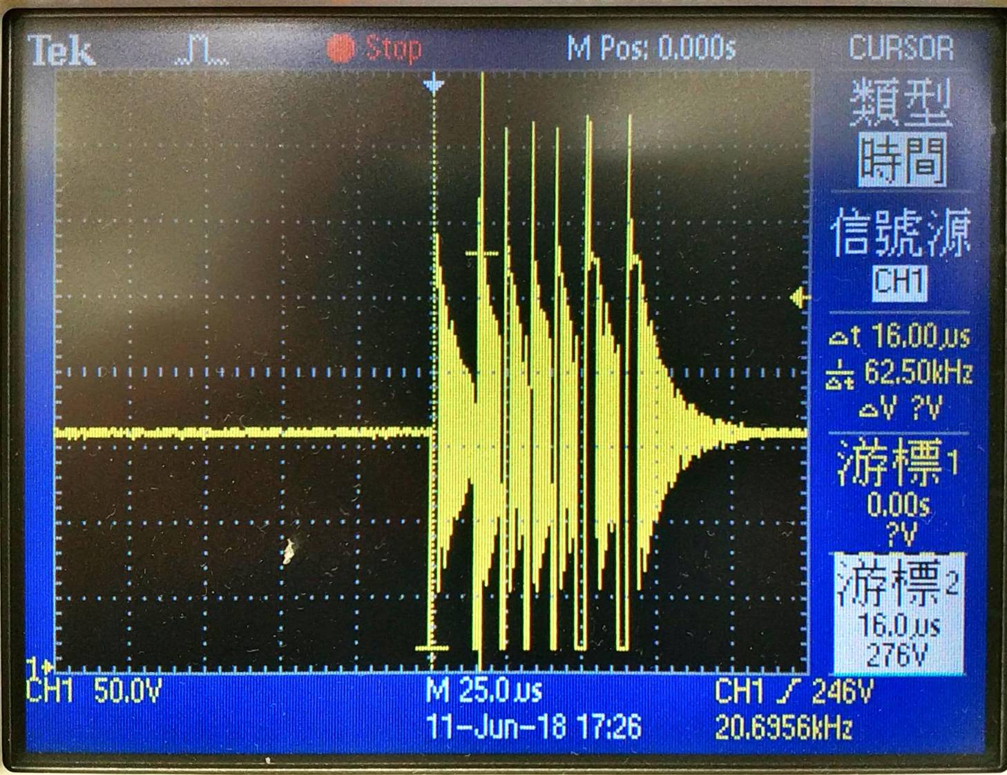

    Here is the measurement waveform that they connect 100ohms at load which means output current = 70mA. (Has audible noise).
    Figure 1. Drain to GND
    Zoom in
    Could you please let us know how to solve the audible noise at Vin:110V, Output: 7V/70mA? Thank you.

    The controller seems to be misbehaving because of it is switching in packets, I will recommend to check the VDD if in case it is not high enough during this period.
