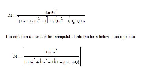

    The FHA gain versus normalised frequency plots may be calculated from this formula - there are two versions in circulation but they are simply re-arrangements of each other and give the same results. I can't do it now but I will try to get some time tomorrow to verify the various plots and see which conforms to these equations the best. If you have MathCad, I can send you the file that generates the graphs.

    I've cross checked the UCC25600 DS (SLUSC846) against the design seminar article (SLU263) and a MathCad file that I used to create the gain curves in the design calculator for the UCC29950 and they all agree with one another. The formulae and curves in these documents are all derived from equation 18 in slu263 (a more explicit version is in the UCC25600 slusc846 data sheet on page 15). The exception is the graphs in the calculator tool for the UCC25600 (sluc146) and I think these should not be used. Instead, I would suggest that you use the peak gain vs Qe curves in the calculator for the UCC29950 sluc576a at www.ti.com/.../toolssoftware.
    As you know the FHA method is accurate only near to the resonant frequency of the the power stage. We do have a more accurate, design tool for the LLC at www.ti.com/.../slua733.pdf . This is based on a numerical analysis of the LLC stage and it was originally produced for the UCC29950 controller but it is valid for any LLC stage - including those controlled by the UCC25600.
