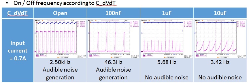

Here, the specific condition is that when the input current is low (about 1A or less) when the Super CAP is in the fully discharged state,
Super CAP Charger IC is repeatedly turned on / off, and noise is generated.
(For reference, our product current consumption is about 350mA, and the Super CAP Charger IC Current Limit is 1A.)
It was also measured that the noise was generated intermittently even if the input current was higher than 1A.
It was reproduced frequently at 2A, and rarely occurred at 3A, but occasionally it occurred.
Therefore, when the C_dVdT value was changed, it was measured that no noise occurred when the On / Off repetition period was below the supposed frequency.

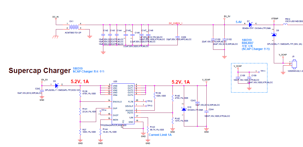

② Finally, we will inquire about the occurrence condition of Figure 66 Graph on datasheet and the noise caused by it.
On the datasheet, Auto Retry and Recovery is described as Overload Condition, It is inquired whether it is repeating 3 times arbitrarily, whether it is condition that On / Off is repeated continuously like Graph.
We will also send you an implementation schematic.

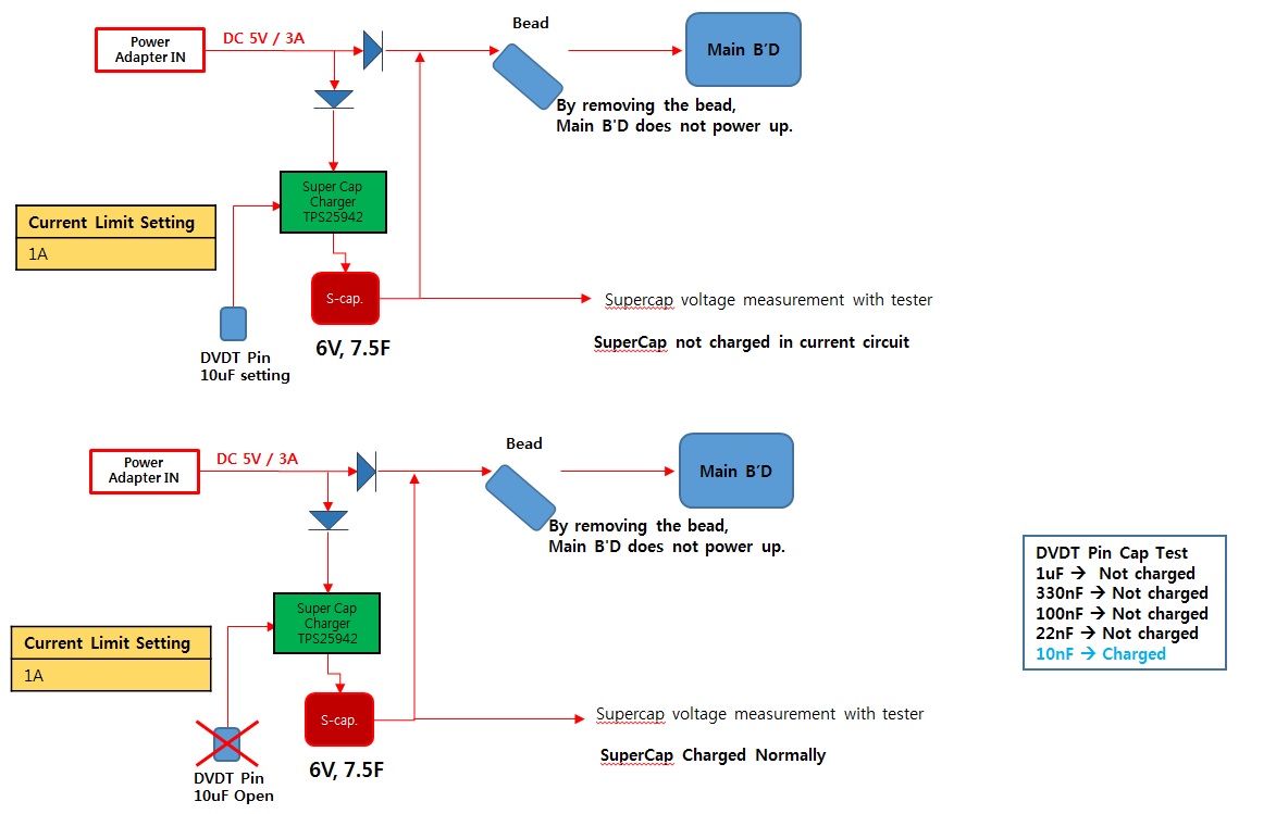

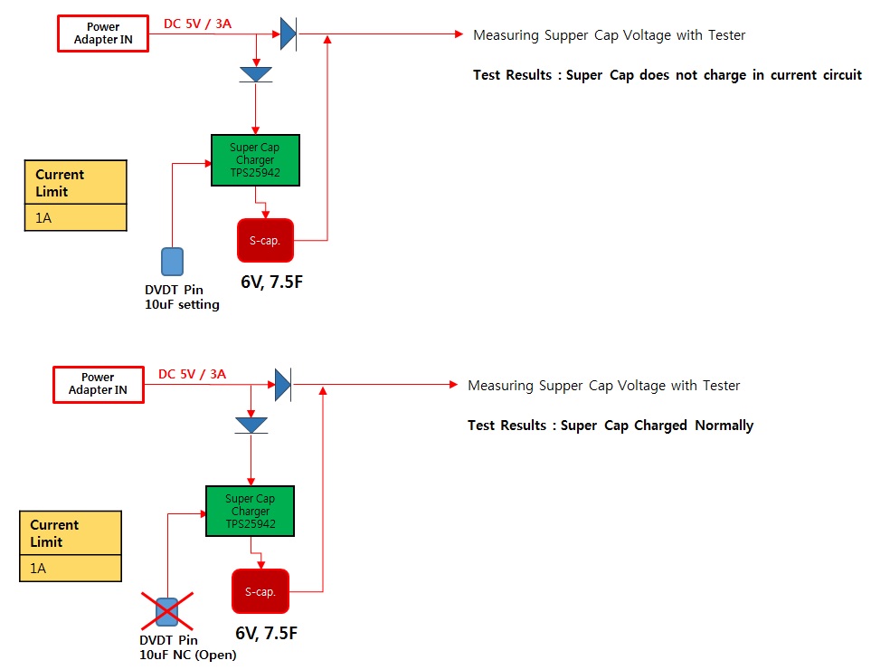

  • Dear Rakesh,
    Sorry for the delay.
    I tested it as follows.
    During the test, the Super Cap can not be charged occasionally in the Charger state.
    If you remove 10uF in this state, normal charge will be done.
    Is the problem of the capacity value of DV / DT?
    Are there recommended capacity values?

  • Dear Rakesh,
    The meanings of the words are as follows. (the Super Cap can not be charged occasionally in the Charger state)
     => Sometimes the Super Cap is not charging. In other words, it means that it can not be charged.
    I will share the test waveform again next time. Before that, can you solve this problem?
    Customer believes that this device is not suitable for supercap charging.
