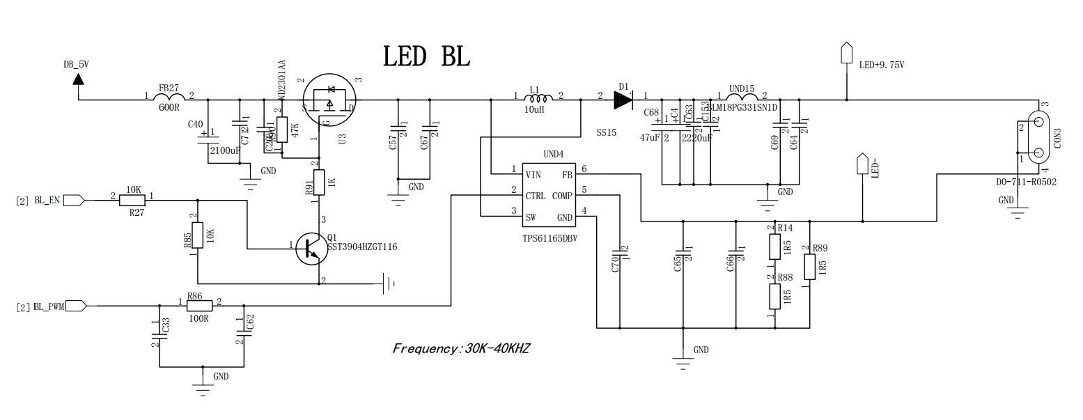

My customer use tps61165 in one of their display module, they use 47uF (16V,  aluminum)+220uF (16V,  aluminum)+0.1uF (ceramics) as the output capacitor, however, they faced with some output capacitor failure (C4).
According to d/s, the recommended output capacitor is 1-10uF, is there any something to do with the capacitor selection?
Thanks.
