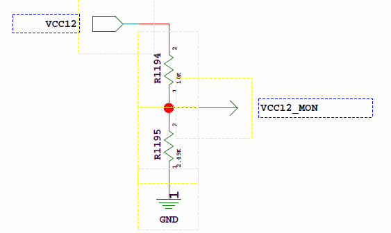

I want to monitor 12V and I have used following voltage divider. VCC12_MON goes to AMON pins.
What value should I have to set in Vout Scale Mon field of Fusion GUI.

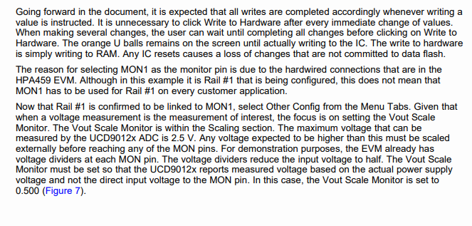

In the document (Page no.5 configuring pins throgh fusion gui.pdf) I have attached Vout_scale is set depending on the resistor divider value used.
Can u clarify what I have to follow now. Since they have used equal resistor its 0.5. What would that will be in my case 0.199 or 0.8 ..??
