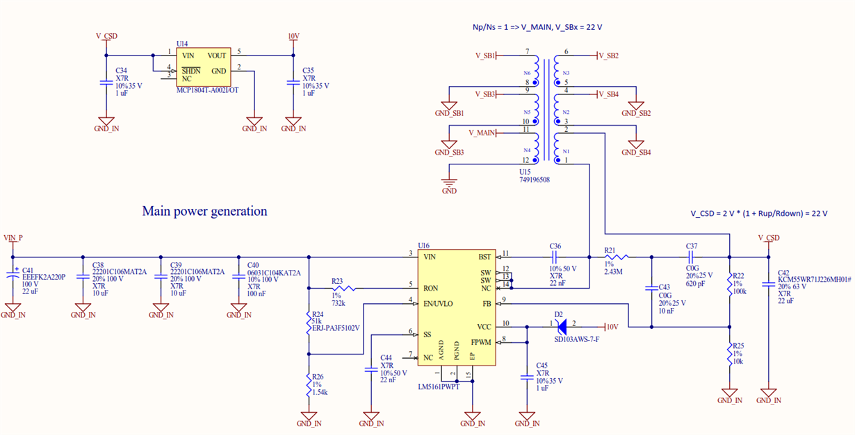

I have this power circuit on a board:
My problem is that the circuit does not work (output = 0 V).
I have a very similar circuit on another board, which is working perfectly (it only has some different values as it generates 10 V from a 24 V input and has 10 secondary outputs...).
Parameters:
- 48 V input
- about 0.6 A of total output current (primary + secondary outputs)
- the transformer's turns ratio is 1:1:1:1:1:1
What I tried:
- D2 away: no change
- only transformer pins 1&2 connected: V_CSD = 22 V as expected
- only transformer pins 1, 2, 11, 12 connected: no output
- only transformer pins 1, 2, 3, 3 connected: no output and something got burned (well, I cannot see anything burned, but I can smell it...).
Have you got some advice?
Thanks in advance
Stefano
  • Hello Stefano,
    This will probably take some back and forth. A couple of quick checks to start with:
    Are the diodes (not shown) on the secondary windings able to handle the increased voltage?
    Try a lower input voltage similar to your other design to see if high voltage spikes are interfering with operation.
  • Oooookay Robert, I made a BIG mistake: no diodes on the main output. All the SB_x outputs have a diode, but the main one has not.
    Now I am testing it all again. Apart from a new burning smell (I will have to double check later), now I have all voltage outputs.
    Bottom line: NEVER design when you are in a hurry...
    Thanks for your help.
    Stefano
