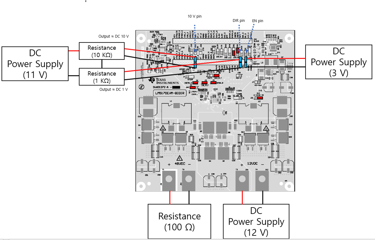

I want to run EVM in Boost Mode.
The configuration was as shown below.
The jumper configuration is as follows.

[MCU Pin]
EN : 3 [V]
DIR : 0.5~1 [V]
10V : 10 [V]
Is my configuration wrong?
I can not tell what was wrong.
When applying the voltage to the MCU pin, there was no separate jumper wire.
There are two questions.
1. When the EVM BOOST mode is active, is the jumper and MCU configuration as appropriate?
2. When voltage is applied to the MCU pins, can the voltage be applied as shown in the picture?
So I moved the jumper on the other EVM and connected it to the MCU and applied the voltage.
Can I apply a voltage like this?
Answers I'll wait.
