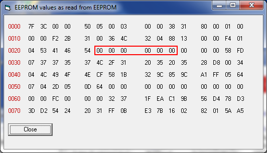

We received a customer return about a BQ2060a circuit : no LED activation after pressing on the button.
LEDs and button are compliant. Furthermore, the voltage of /DIPS pin, drop after the pressing.
Note : Voltage/Current/Temperature calibration are compliant.
However, after a initialize command, the display function is operational again. But Voltage/Current/ calibration were not compliant.
It looks like a bug of the app. Have you ever had this type of problem?
