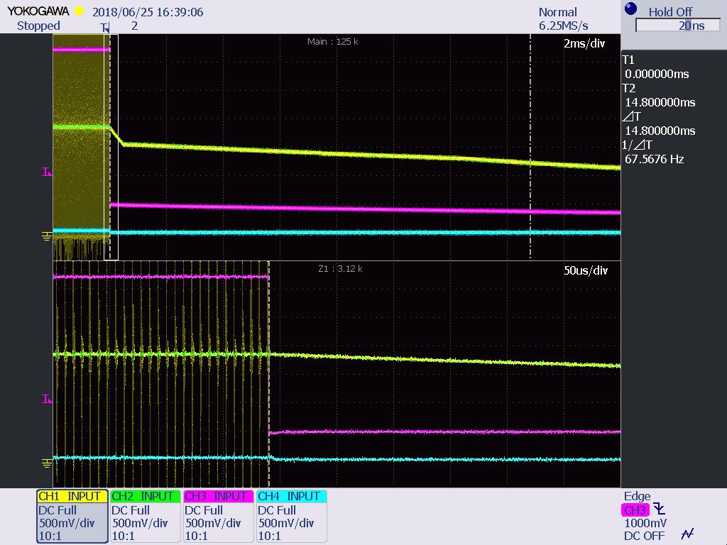

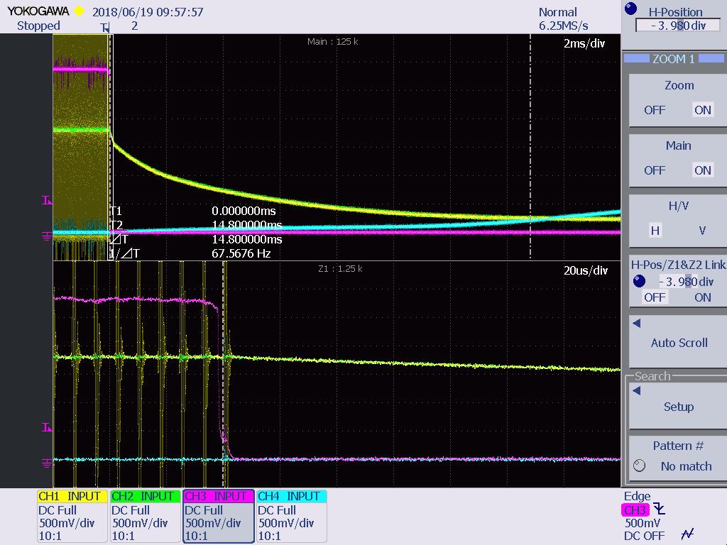

    I am working with the chip designers on this. We would like to see a scope shop showing E2 (L1) Pin. We want to verify that the part is in PFM mode. I realize that the registers are not forcing PWM, but that does not mean that the part is making it to PFM mode.
  • The purple signal is the button (B1) measured on pin 2. The blue signal is HOLD_DCDC1. The yellow signal is pin E2 (before the inductor). The green signal is the net +1.8V measured after the capacitors C41 and C42.
    You can see that the yellow (pin E2) and green (net +1.8V) signals decrease quite slowly. I believe that this is because the product is a lowpower design so once the processor is turned off there is nothing actively loading the net. You can see that the blue signal (HOLD_DCDC1) starts to slowly rise once the button is released. Once the processor is shut down there is nothing actively loading this net so it somewhat starts to float.

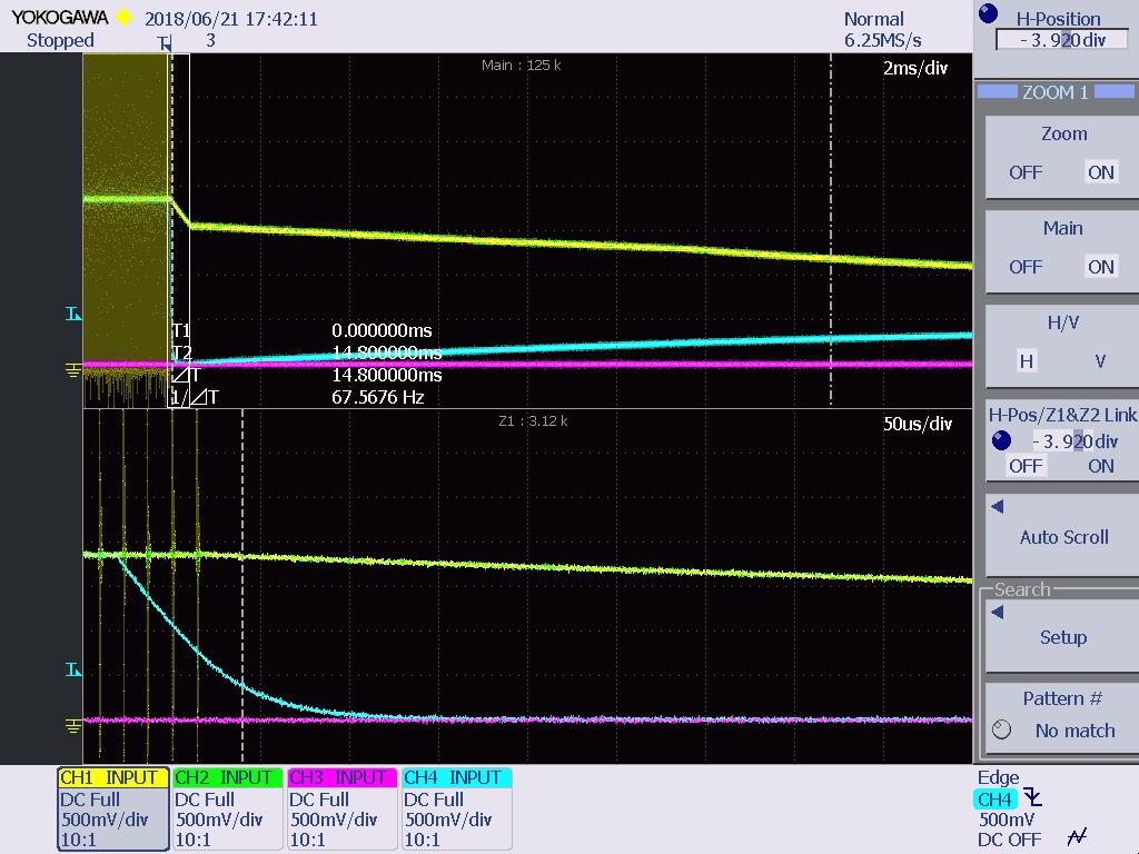

    I believe we have managed to isolate the issue. We loaded the device with a special primitive software. This primitive software makes the processor turn on the TPS65720 using HOLD_DCDC1. After a few seconds the TPS65720 is turned off pulling HOLD_DCDC1 low. There is no I2C commands send to the TPS65720 so it is using all default values.
    We noticed in this test that the current into BAT1/BAT2 is low after the TPS65720 is shut down. The current consumption is the same as if we would have disconnected and reinserted the battery. I believe that this points towards that the issue with 1 mA current lies within the state-machine of TPS65720 or how it responds to the register settings that are made through I2C.

  • Same device as previous measurement (no changes to the hardware). Same instrument and same test setup. The only difference is the software running i the processor.
    Signal colors are the same as previous (The purple signal is the button (B1) measured on pin 2. The blue signal is HOLD_DCDC1. The yellow signal is pin E2 (before the inductor). The green signal is the net +1.8V measured after the capacitors C41 and C42).

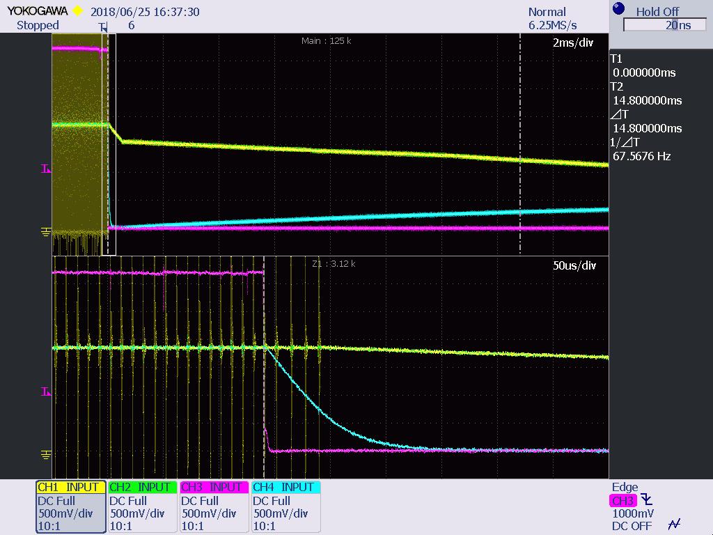

  • Picture 3
    Picture 4
    We tried two new softwares to find out if there is any unexpected behavior in the state machine of TPS65720. Picture 3 and picture 4 (above) show the shut down sequence. Signal colors are the same as previous (The purple signal is the button (B1) measured on pin 2. The blue signal is HOLD_DCDC1. The yellow signal is pin E2 (before the inductor). The green signal is the net +1.8V measured after the capacitors C41 and C42).
    The two new softwares change state of HOLD_DCDC1 and PB_IN in a different order to see if there is any dependency. Both these softwares give a reasonable shut down current. This points towards that the problem is related to I2C.

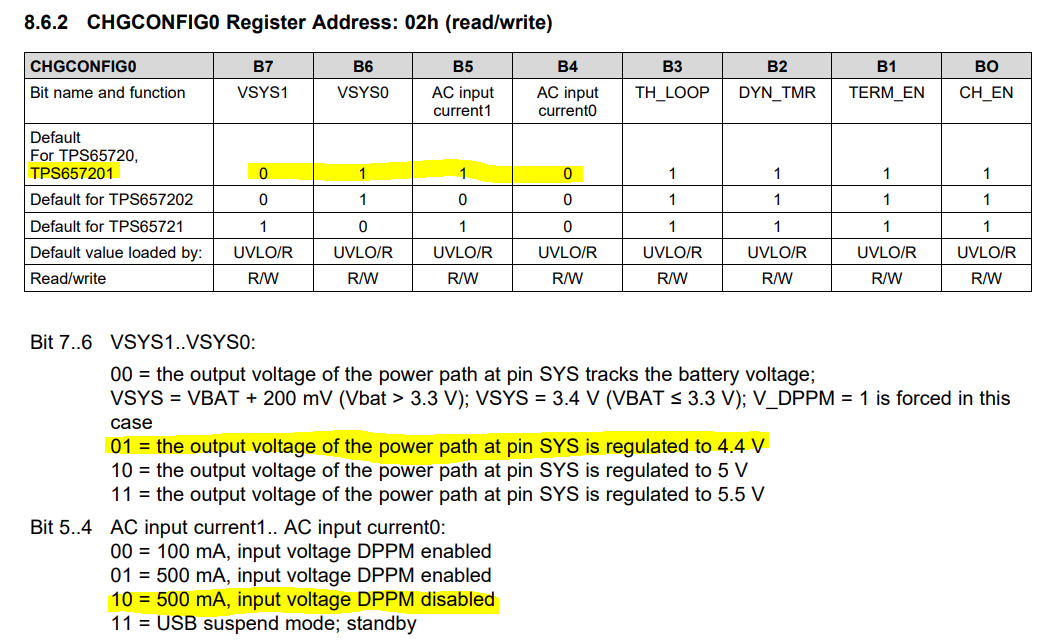

  • In the Register dump you provided early on in this thread, it says:
    CHGCONFIG0 [0x02] = 0x4F
    The default (reset) value for this register for the TPS657201 is 0x6F
    When this Register == 0x6F, then VSYS[1..0] = 01b, AC input current[1..0] = 10b, which means that the DPPM is Disabled.
    In this case, the SYS voltage is un-regulated.
    When AC input current[1..0] = 00b, the DPPM is enabled and VSYS is regulated and will be 4.4V when VSYS[1..0] = 01b
    Although the load on SYS should be low, the current consumption could be coming from the DPPM circuitry itself or the PMIC is burning current in order to generate VSYS = 4.4V from VAC = 5V (typical) or higher.
    This may not be the root cause of the issue, but it was the first mismatch I identified with the TPS657201 default registers and the data dump you provided.
