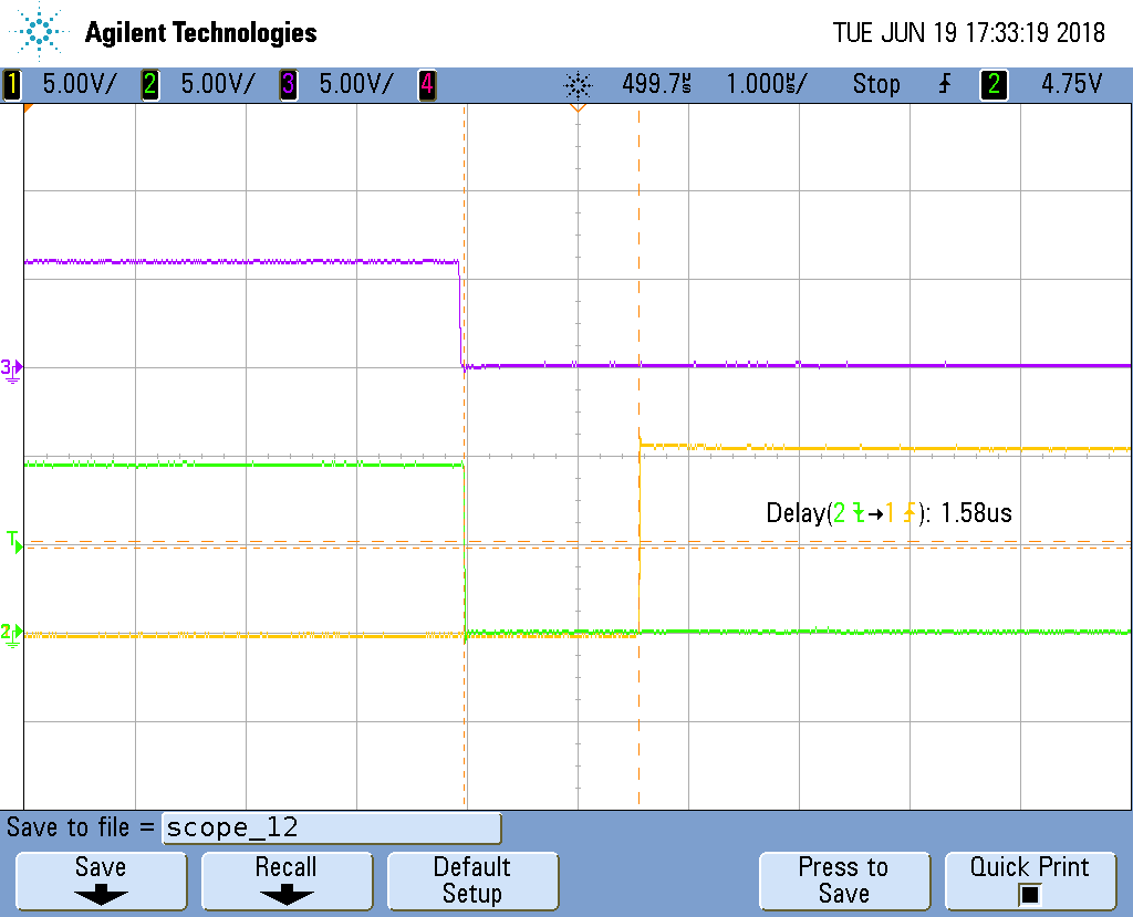

My customer has one question regarding what is the maximum allowable dead time setting for LM5106? Datasheet suggested the RDT resistor should be 10k to 150k. But in my customer's design they need at least 1.5us of deadtime, can we increase the resistor to around 300k to get 1.5us deadtime? What is the maximum allowable RT resistor value?

  • Hi Wei,

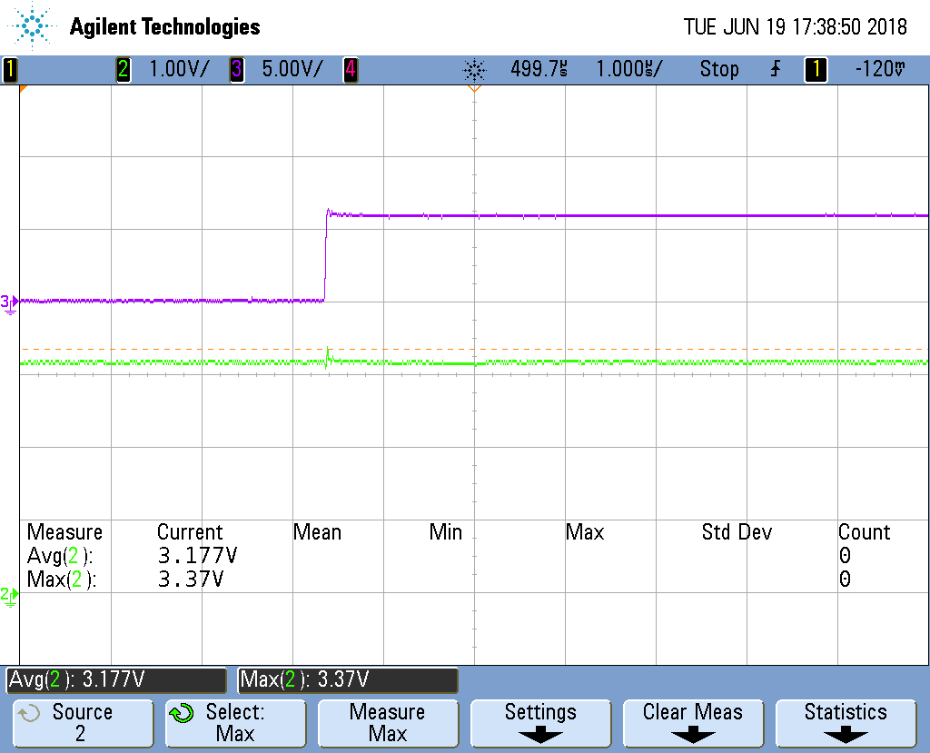

    After putting the part on the bench, I captured the following waveforms. The DT is set by a ~300kohm and results in ~1.5us. The voltage on the DT pin can be seen as well to be ~3.17 however as discussed before, due to more impedance on this pin there will be a smaller current source and signal to noise ratio on this pin. The max DT voltage is specd at 3.3V so this doesnt leave much headroom for fluctuations, as can be seen during  simply switching the input with no filter, a noisey ground will certainly be of concern.
    purple: Input
    green: HO
    yellow: LO
    purple: Input
    green: V_RDT
