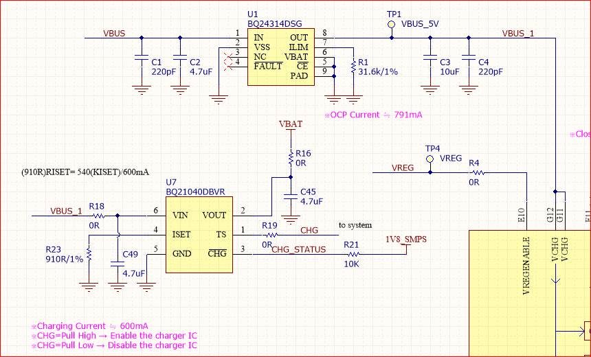

Here are two question about #CHG:
1.  While plug in DC source, the #CHG doesn't goes low, but the charging current is correct.
what is the condition that #CHG goes low I can check,  only the charging current?
2. For the 600mAh battery, and  fast charging current set to 570mA---the CC stage is very fast, but even through 2Hrs passed, the CV doesn't go to termination, charging current is still 90mA, how to improve the charging time?
Thank you.
  • Hello
    Can you send a schematic of the circuit?
    1.) CHG pin will only go low for the first charge cycle, later recharges will not show on the CHG pin.
    2.) Short CC phase and long CV phase does not sound right. What is voltage on the battery and could it be in thermal regulation?

  • I double checked this in the lab with bq21040 EVM and everything works as expected. Took a closer look at the /CHG pin behavior with TS pin pulled high and in a TTDM but could not trigger the condition you are describing.
    Somethings to check on:
    1.) How is the TS pin configured, is it under the control of a micro? Can you test with it grounded with 10k?
    2.) Is a system load connected to OUT in addition with to the battery?
