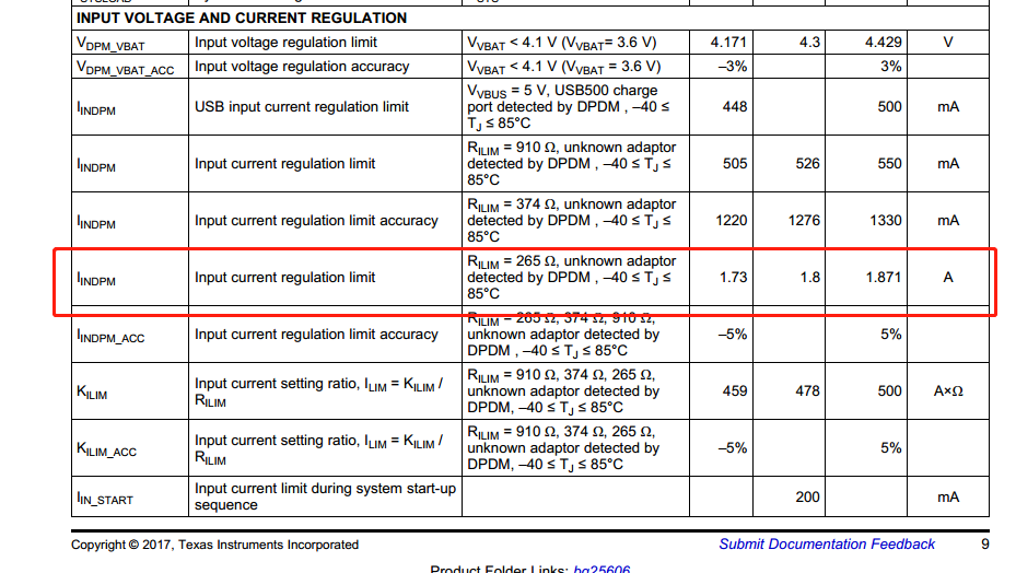

Hello all,
            I'm not going to use the quick charge protocol right now, I'm going to suspend D+ /D- .And then the current is 2A, the input is 12V, and what is the calculation of the ILIM current?
I only found the maximum 1.8A resistance configuration in the manual, but did not see the 3200mA.
