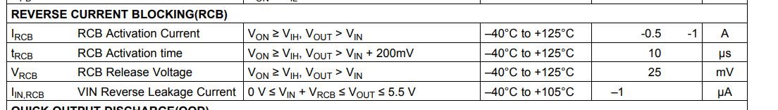

I am using TPS22918 load switch with 5V as input voltage and ON control is given to external 3:1 Header. In my design the output of load switch is connected from external 5V also as the bypass option and load switch will be disabled in this condition. Is there any chances that if the external 5V is used that will cause reverse leakage current through internal FET or it will be completely isolated from input since the ON control is OFF condition.
