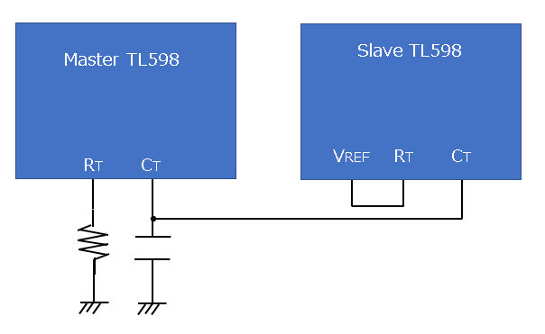

Can TL598 do synchronization of internal oscillator with another device?
I image circuit below.
Shimizu
  • Hello Shimizu
    The datasheet for the TL598 also recommends how to synchronise two parts: Connect RT to VREF and provide a saw tooth to CT.
    You may need to buffer the master CT waveform in case the pcb trace picks up noise or the slave loads the master oscillator.
