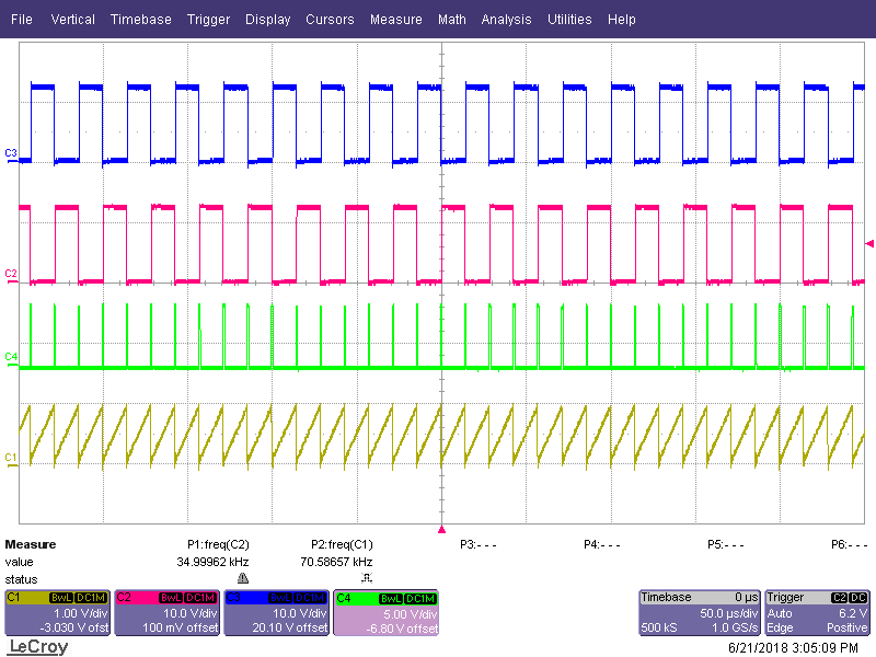

  • Hello Stephan
    Thanks for the component values. I put them into my test board and the free running oscillator frequency dropped to 25kHz (12.5kHz on the OUTx signals).
    I was then able to synchronise the oscillator up to 70kHz (35kHz on the OUTx signals) as you can see in the image below.
    I am waiting for some more information from some colleagues but I don't need the waveforms from you any more.
    Colin

  • Hello Stephan
    UCC2895: I used the CT and RT values you sent me - 470k and 820pF. If you leave the SYNC pin open circuit then the controller runs at its nominal frequency which was about 25kHz (12.5kHz at the OUTx pins).
    I then connected a signal generator -0 to 5V directly at the SYNC pin - no other changes. The signal generator output was 70kHz and the oscillator synchronised up to this frequency so the OUTx pins ran at half this, 35kHz.
    The UCC28950 oscillator will pull up to the SYNC signal but it will also pull down a little (the oscillator on the UCC2895 pulls up only). I will check the SYNC range of the UCC28950 - probably on Monday.
